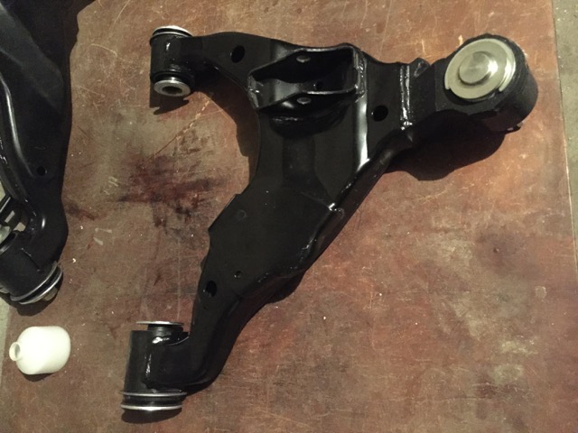

Next on the to-do list is new UCA's and LCA's. I got the ebay UCA's and aftermarket OEM spec LCA's IMG_2942.jpg
This is the passenger side, with the front on the top, for reference

Now here's the issue, I was laying all the parts out in preparation for the install this coming Wednesday (10/14).

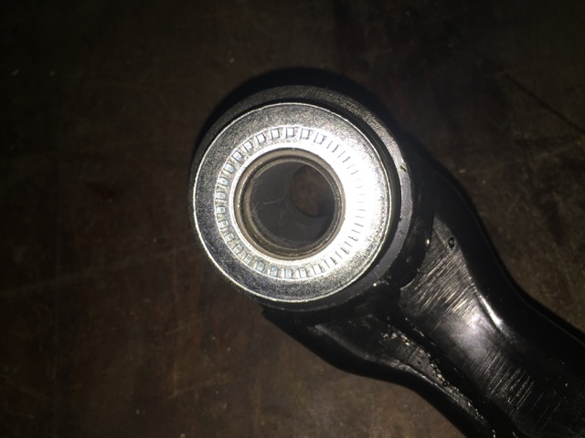

The bushing sleeves are different diameter front vs rear. Here is the front:

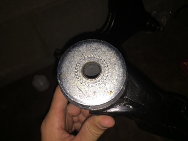

and the rear:

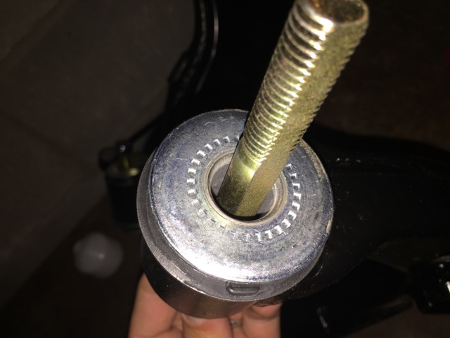

The camber bolt fits snugly in the rear bushing

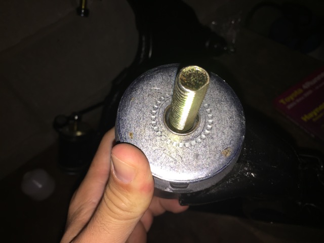

But flops around in the front
SOOOoooooo, what am i missing here since there obviously must be some other sleeve that goes in here? The new bolts are the same size when lined up against the current bolt thats in in the LCA, but I've been looking online for hours and can't find the missing piece. I believe there's a sleeve that I'm supposed to reuse but story after story says that sleeve is often seized up so bad that it can't be removed.
1: Is my reasoning correct that there is an extra sleeve I'm supposed to reuse?
2: ANYWHERE TO BUY THIS MISSING SLEEVE??? - In case I can't reuse the stock one
So, please, help me out.... someone?

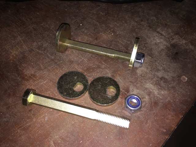

Those alignment bolts are not correct. Get some OEM ones.
Sorry I don't have a better picture, but you can see one of the OEM bolts at the top left in this picture.
So are the OEM's different diameter front vs rear?
And anyone have a link for the complete alignment bolt kit? all the parts sites I've looked at have every component separate instead of a complete kit
Yes, they are different.
Toyota doesn't sell a kit, they are bought individually. You're on your own with aftermarket stuff. I have found that the hit or miss with aftermarket parts, for the most part, is simply not worth the hassle. YMMV

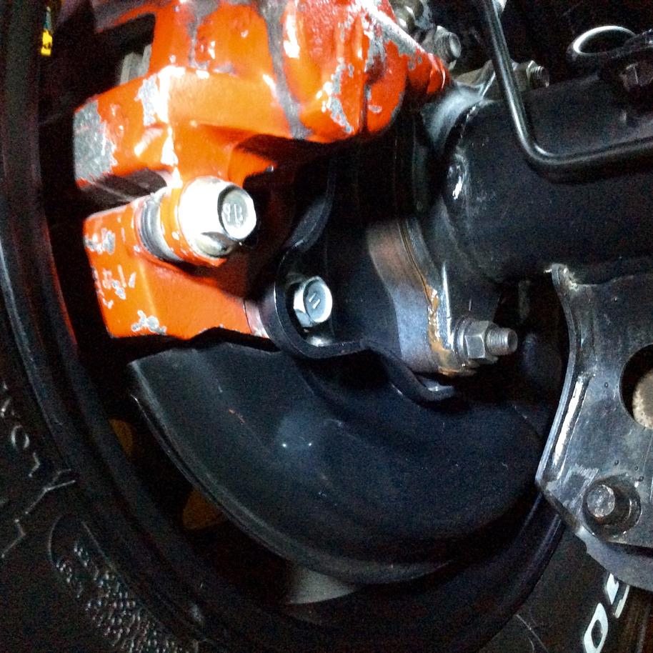

Speaking of axle seals maybe you would know ...does this look like a leaky axle seal in your opinion
That doesn't look like a leaky axle seal to me. A bad seal will let differential oil through and it'll get all over the place quick since it's a liquid. Whatever that stuff is that's oozing out isn't differential fluid unless your fluid is contaminated and has gelled up somehow.
I really don't know what that orange goo is, honestly. I think you'll need to pull the axle toto find out. It should be pretty obvious when you get it apart.

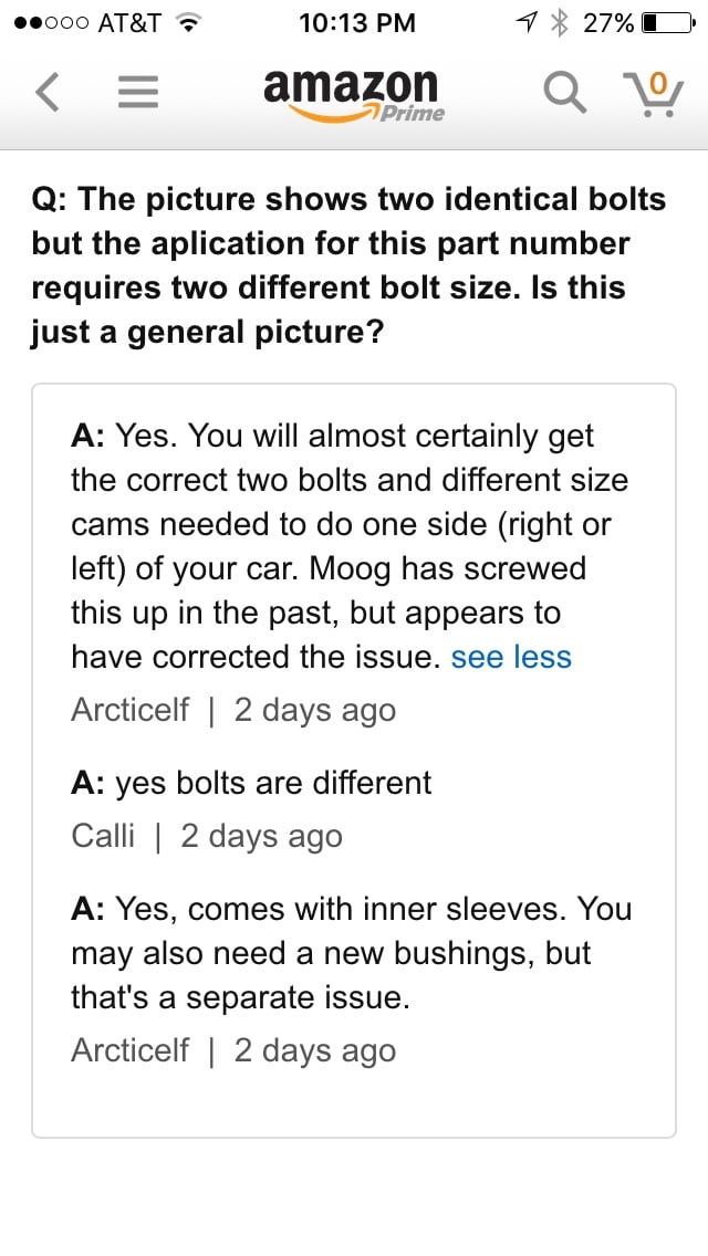

OP, you're missing a sleeve that goes on the front bolt. It is about as long as the bushing and also has two holes in it to allow the grease to get out to the bushing. I bought two Moog bolt kits from Rock Auto and both of mine came with the correct parts.
Just did the same thing, probably the same kit. I ordered my cam bolts from Wheelers offroad and the bigger hole has a bigger bolt and a sleeve that goes around the bolt.
What a difference after new bushings!!!! So much better!!
Do you have the link for the kit you bought? Thank you
