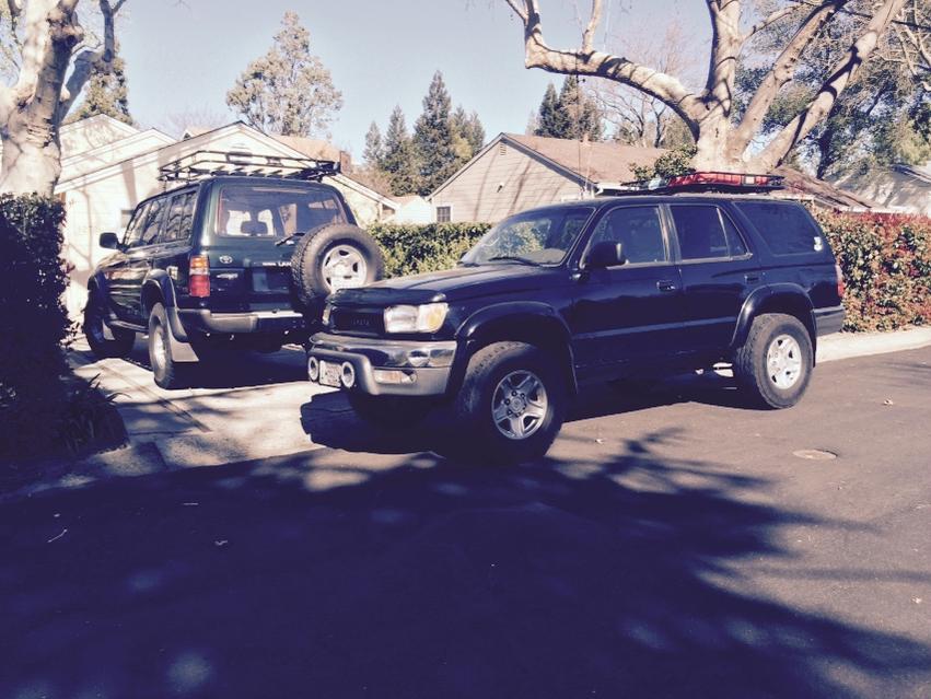

Hi All,
I have a 2002 4Runner with 234k mi with either a cracked head or leak in gasket, I’m just assuming a cracked head.
The truck is in great shape inside and out otherwise so I would hate to put it up for a cheap sale.
I’m estimating it would cost me around $500 to fix myself if I don’t find any other problems and that would get me back to a motor with 234k mi.
Now I see these JDM motors on ebay from $900-1300 and I’m intrigued. From what I read I can ‘replace’ my California engine with one, 5VZ-FE with a 5VZ-FE. From the posts I have read it looks fairly straightforward, what other costs should I be anticipating? How much tougher is it to replace the motor vs change the head gasket/repair the crack (or replace the head)?
I also see a local motor for $1450 out of a 4runner with 136k mi. Local motors seem to be more money with higher miles than a JDM, this one seems more reasonable than others I have seen. Is there a benefit to a local motor over a JDM with fewer miles?
This whole thing seems like a big task for me but my neighbor has done it on a 1st gen and a buddy of mine is a great mechanic and will help. What do you guys with experience think?
