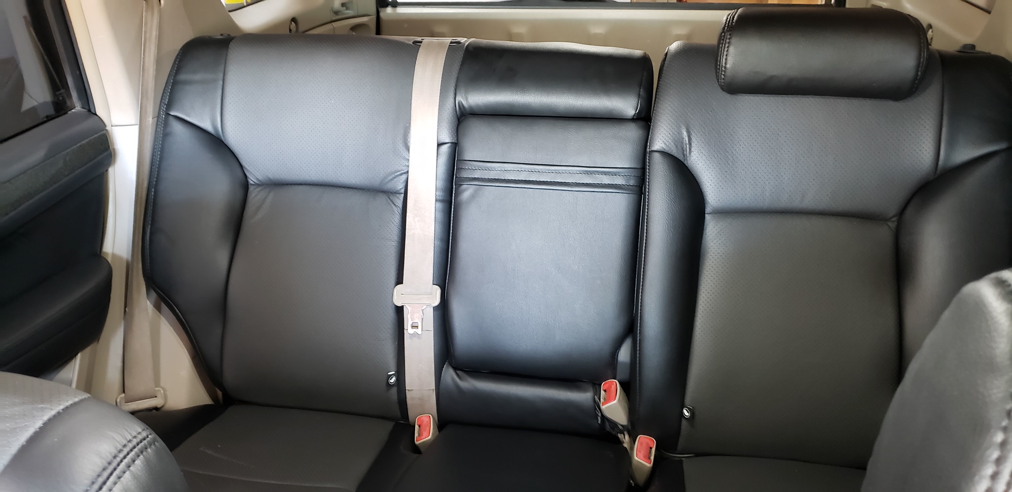

I used leatherseats.com to replace all my factory leather. Going on 3 years since I did them and the leather is holding up excellently.

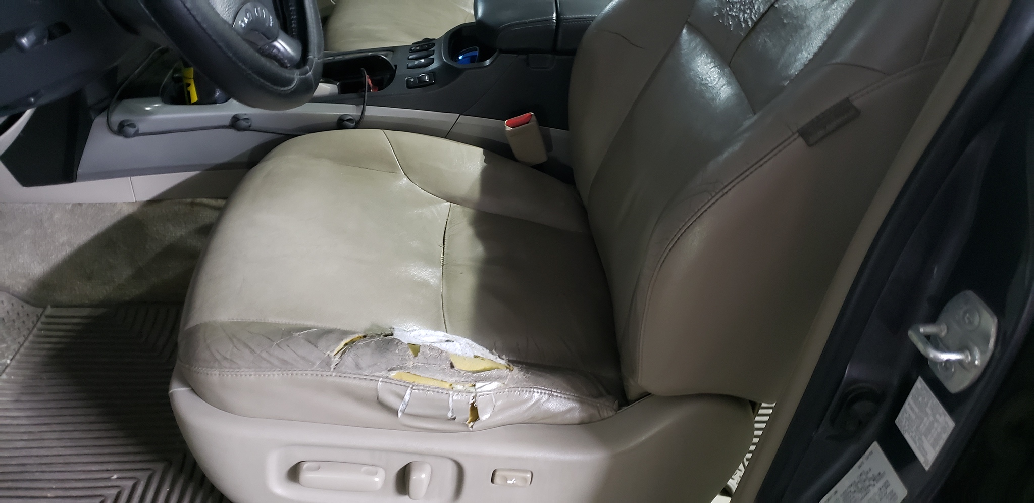

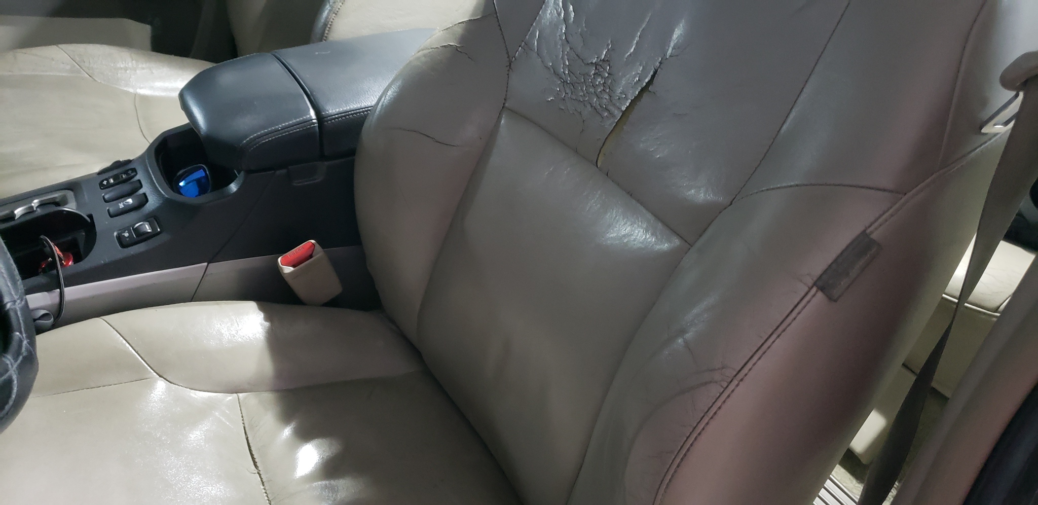

Driver seat before with worn out OEM leather and seat cushion.

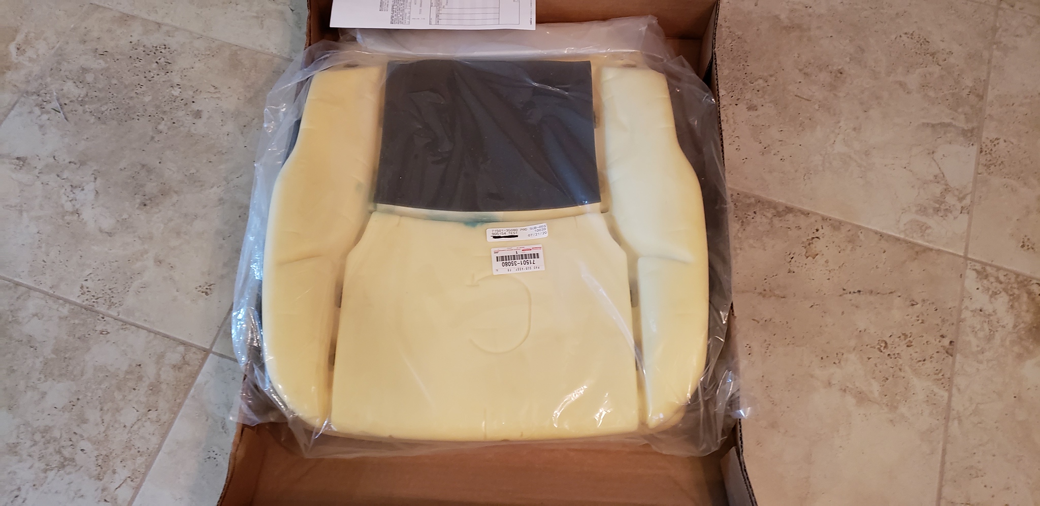

New OEM seat cushion for driver side. Part number is in the pic.

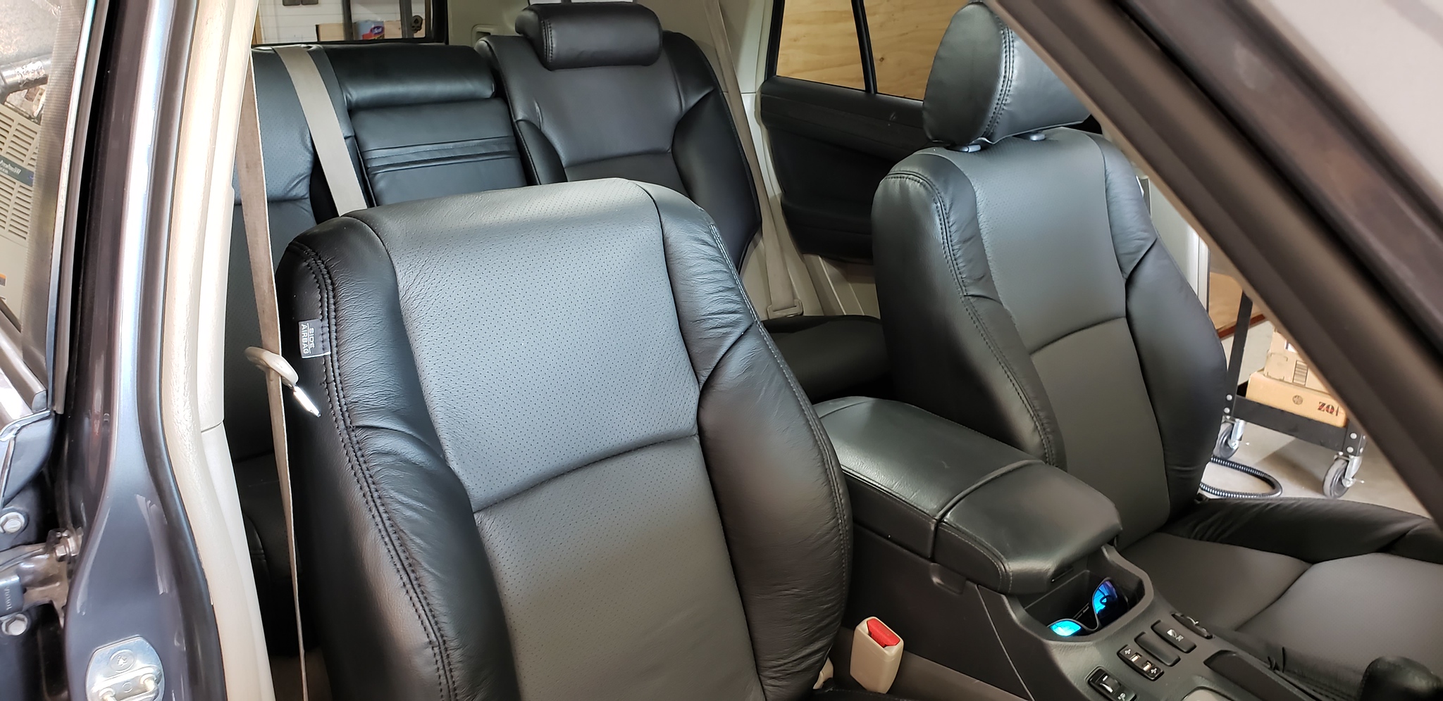

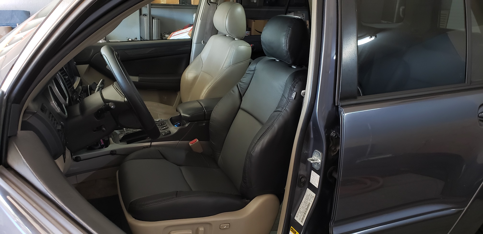

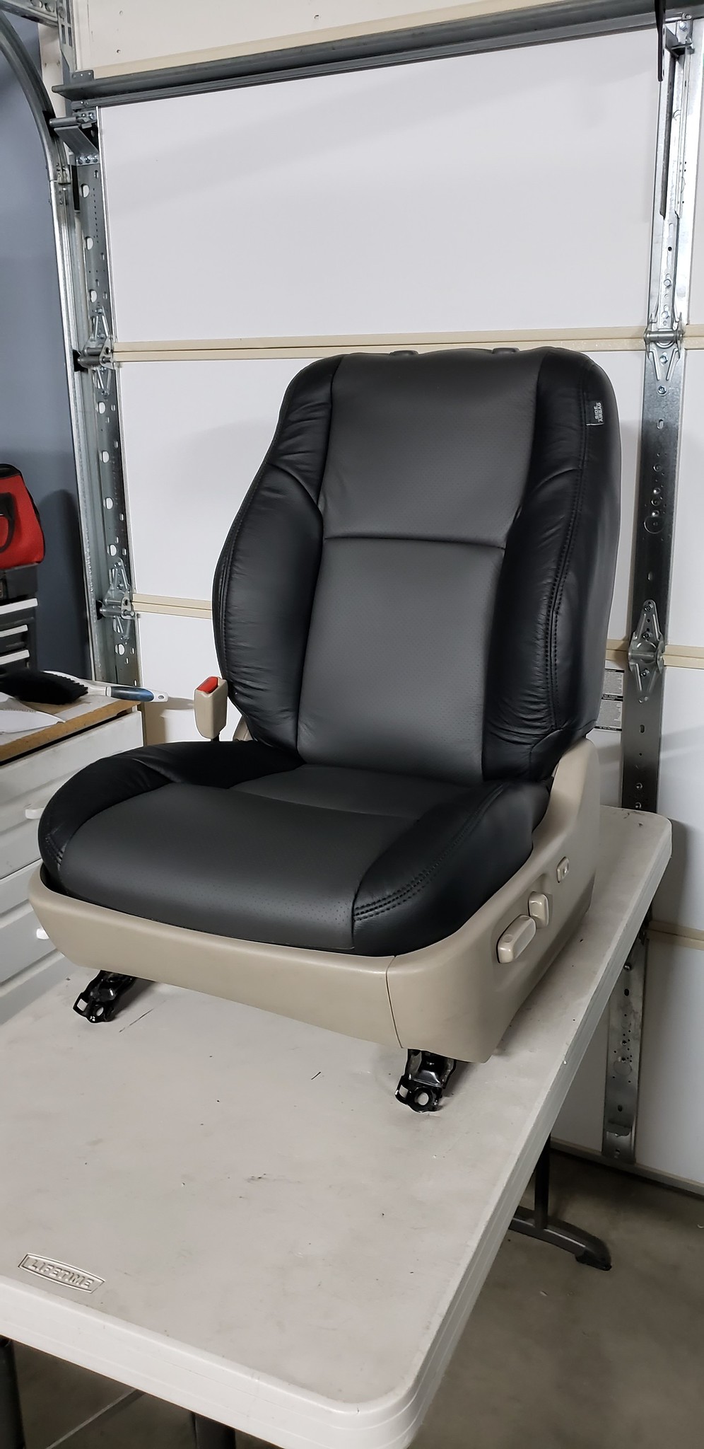

Completed driver seat. The wrinkles all came out after a few weeks and the AZ heat. They are complete replacement seat covers. I did all the work to replace them myself in my garage. leatherseats.com sells everything you need to do the job.
Front and rear done. I was still working on the headrests when I took these pics.
Hope that helps. Highly recommend leatherseats.com. I've been extremely happy with the seat covers since I installed them.
