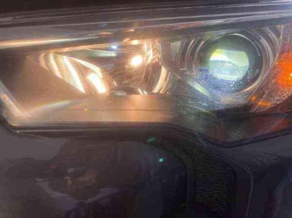

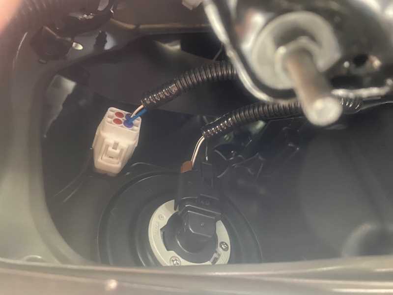

Do the Pros have a removable high beam? Appears my led low is sealed in there. Is the small 2 wire connector closest to the radiator for daytime?
Do the Pros have a removable high beam? Appears my led low is sealed in there...
The 2021 TRD Pro’s low/high are in one LED Projector Module. The high beam, when activated, moves a shield and allows all of the light from the LED Chip to be projected thru the lens.
In the 2021 TRD Pro, the DRL is still a halogen, located in the place of the previous year model DRL/High Beam bulbs.
I would love to get a model number for the plug and play LED high beam for my 21 TRD-OR. This is starting to annoy me now, lol. Looks like a simple swap out.
Ahh yes, I do recall reading that. Have been reading too many threads about Leds. Led retro it is, not changing housing just yet. So far the Led lows with fogs have been plenty.
