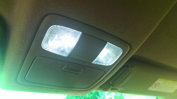

I had 2 festoon LED left over and I stuck them in the visor mirror lights. I had to bend the prongs back a bit since the stock bulb is narrower, and the festoon did not fit that well. But they stayed in there with the plastic cover on.
