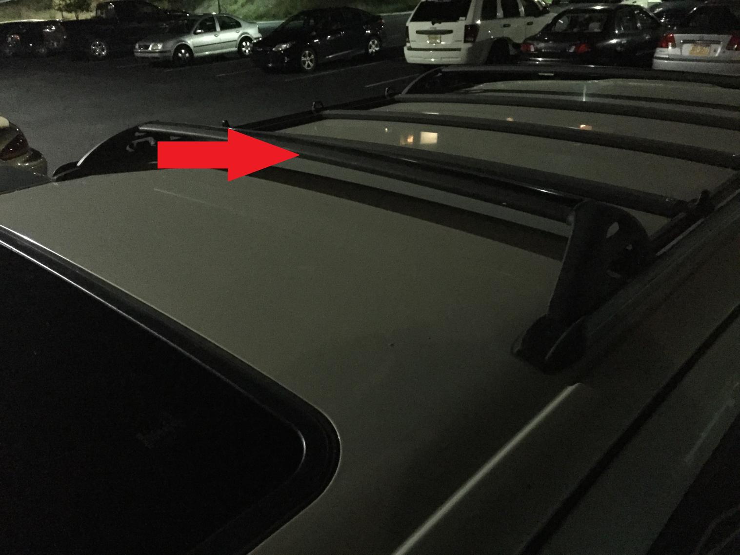

I've been looking around the forum for people that have installed LED light bars, but it seems that most of them have been just above the windshield or in the front bumper. Does anyone know of anybody that has put them on the stock roof rack? I don't really want to drill any holes into the body itself, so if I could get away with just drilling into the roof rack that would be preferable. (See attached picture)
Also, are there any recommended brands/sizes LED Brands? I don't really want to spend a ton on it, maybe less than $200?

Mounting it that far back on the cab makes for too much of a cutoff due to shadow from the cab. Your not trying to just throw light out there, you want to light up your path, the light comes out like a cone or wedge and mounting it there would only allow light past the cab like _\ vs > if my text jiblits make sense. Your far view may be lit at cab height but your near path and future tracks will be shadowed. It may provide enough light for what you want to do but I would hardly call it optimal.

This is your best option if you don't want to drill into the roof directly. These use self tapping screws into the gutter, so if you ever decide to remove the light bar there will be no visible holes or anything. And your bar will be closer to the front of your vehicle allowing for more light to reach your immediate path and look better IMO. Downpour's got what you need. :tongue1:

The main thing is that I don't want to drill any holes directly into the body. That far back should still light up farther down the road, rather than directly in front of the truck and farther down. [MENTION=90528]BannerBuilt[/MENTION] did something similar to his 4th Gen, here's the thread http://www.toyota-4runner.org/4th-gen-t4rs/139354-stealth-led-light-bar-install.html

I would actually like to mount it using brackets, but those brackets are a bit steep (poor college kid here), so roof rack it is haha. :violin: It's a never ending struggle of "I would but...Wells Fargo and Penn State says no."
