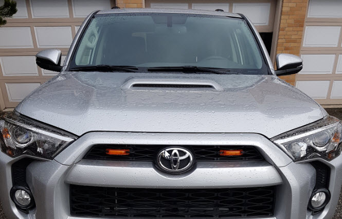

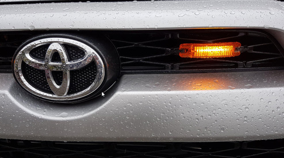

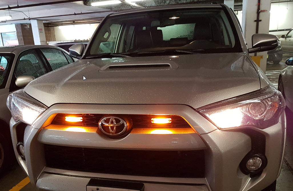

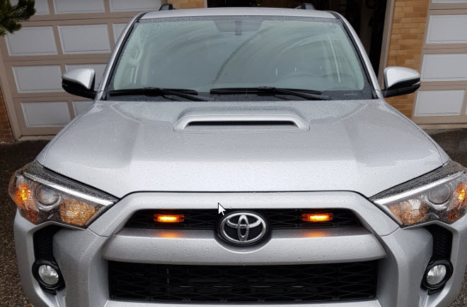

Thanks for all the feedback JK and Ray. All done. I had the itch and was bored so I called a buddy over to help out.
1 hour job approx.
2 LED lights from Princess Auto, 12 gauge wiring, some zap straps to tidy up the wiring, some black tubing to cover the wiring and a 5 ohm external fuse as precaution.
