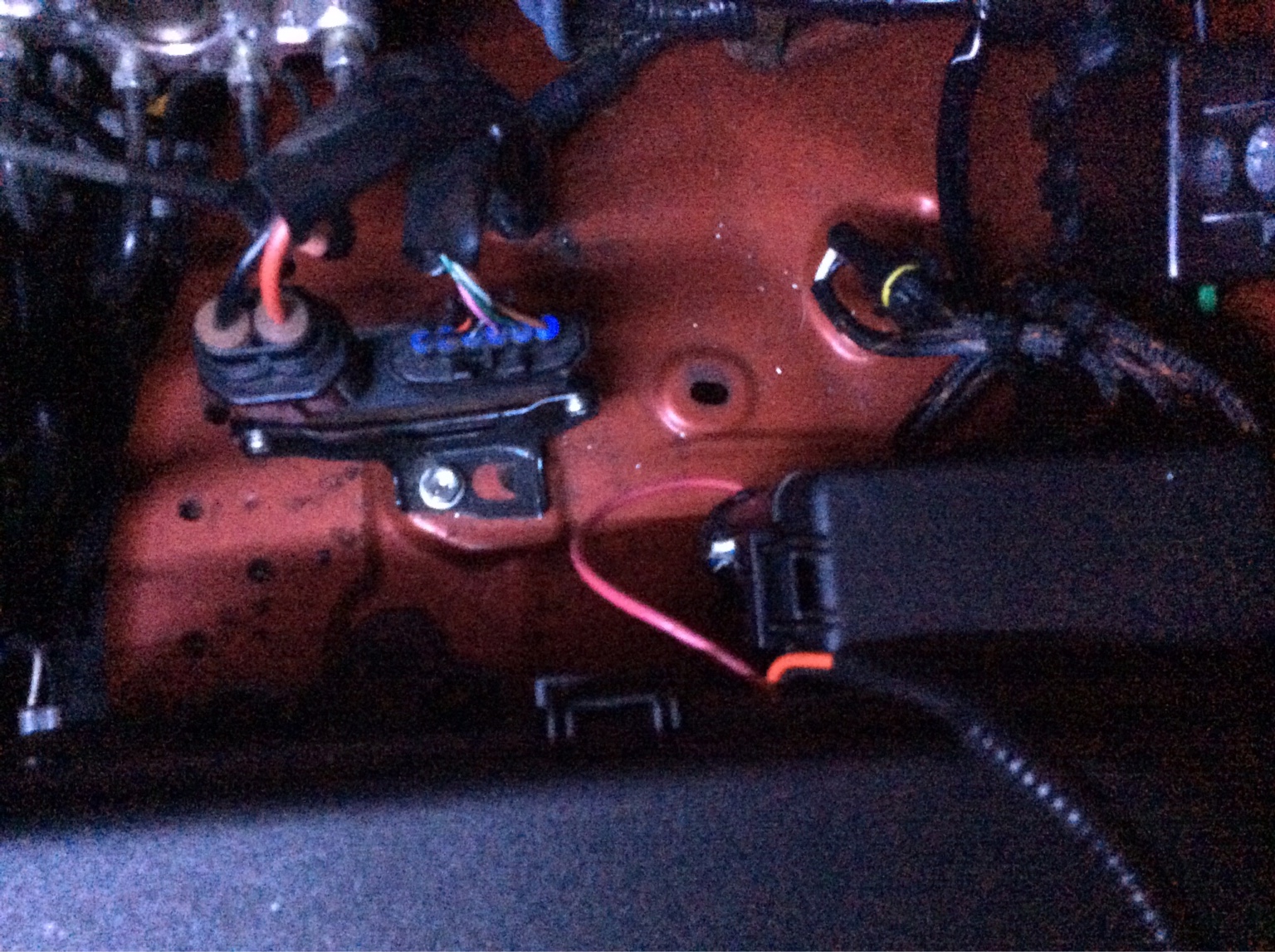

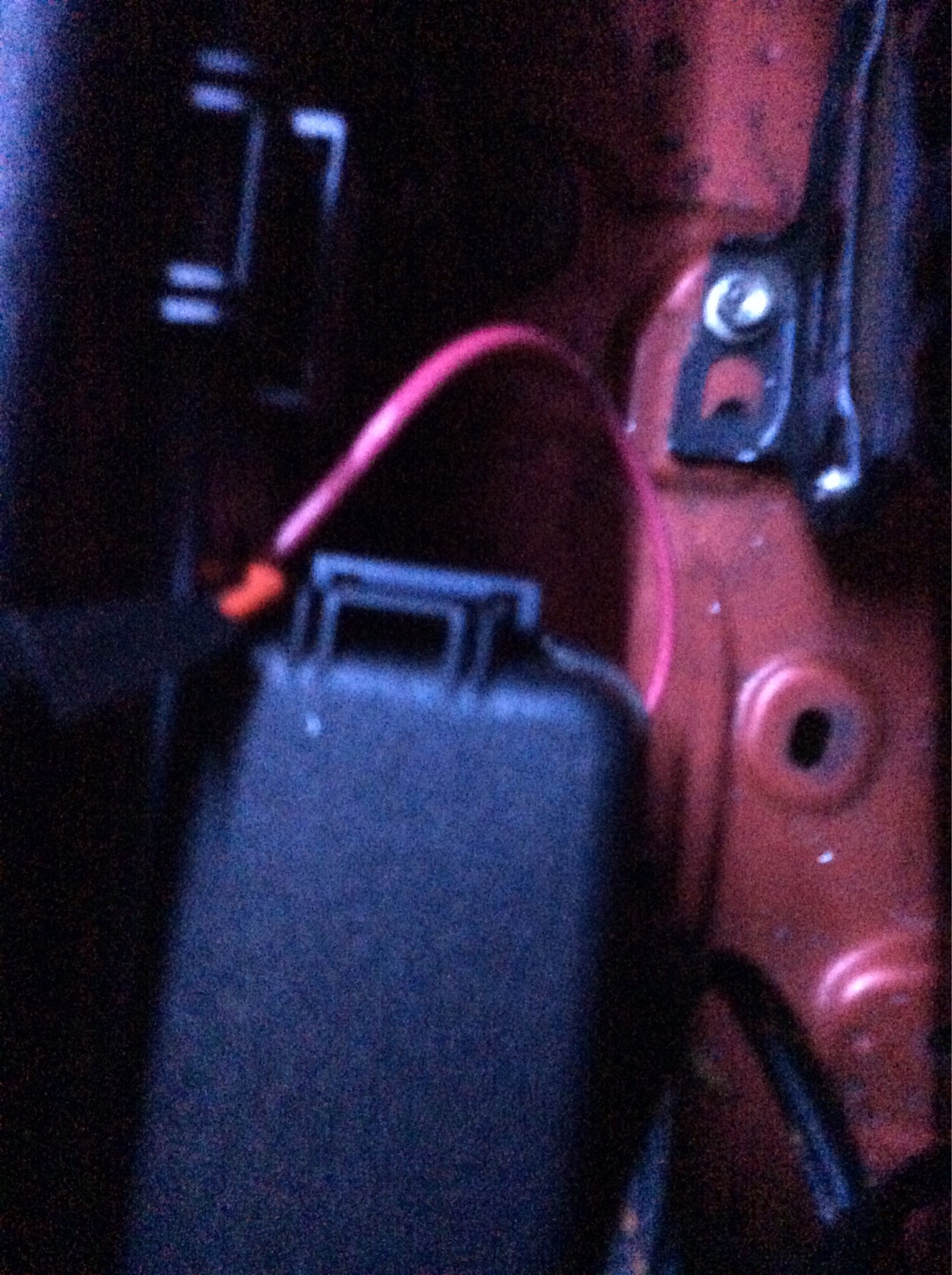

Install was for most part easy. Getting the case next to the fuse box off was biggest challenge. Came out great. Had an issue with a connection and aidanjames customer support helped me out right away. I will shoot pics tonight and post up.

Would it be possible for you to snap a couple photos of where you installed the wiring and/or describe how it is wired?
Thanks!
I'll do my best. I'm no [MENTION=103267]Saker[/MENTION] or [MENTION=65614]Antman[/MENTION]! Basically the kit comes with two fog light covers with LEDs installed and wired ready for attaching harness.
Removing fender liner screws towards front end. Three screws on top two on bottom. Carefully unclip tabs for fog light cover. Remove and insert aidanjames led.
This is where I wondered if I could have this job easier. I attached the leads from fog light cover to aidanjames wire harness after I installed covers. In hindsight I would have added an extension to each lead so I could solder properly as there is not a lot of room to work behind bumper.
Once both sides are wired in remove cover of small box behind drivers side fuse box.
This box is tricky since it is held by four release tabs. Just take your time and pull gently. It will eventually give. I attached the harness with a 3m quick connect and then tucked into fuse box.
Attach ground wire to body ground strap next to fuse box.
That's it. LEDs turn on only with key. I love the look and it flows nicely with front end.
