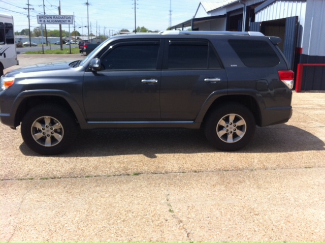

Thanks for the input. I just ordered the 1.5 inch rear kit from them. Also pictured below is the way it looks now.

1. you can run 285s with minor inner fender modification 2. NOPE 3. NOPE
The rear wouldn't need to be aligned as well after the 1.5 lift installed?

Ya, you need the rear spacer to complete the kit to make it close to level .A rear spacer is a rear spacer is a rear spacer and not much technology involved with about 10 different people making them . Here is the rear one by Daystar that goes with the front one you installed......Daystar KT09127BK Comfort Ride 1.5" Rear Coil Spring Spacer Kit : Amazon.com : Automotive
And here's the whole kit..... http://www.daystarweb.com/productdetail.php?productID=1236
http://www.amazon.com/Daystar-KT091...UTF8&qid=1364945899&sr=1-1&keywords=KT09134BK
And you will need an front end alignment any time you do a lift or the camber and toe will be off. No rear alignment needed as it's a straight axle and the rear alignment won't change much.My rear tires have shown no effect in 50k miles since a lift but I do rotate them every 3k miles.
