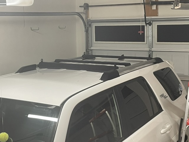

I ordered a full set of LFD roof bars for my 2017 4Runner and they seem to be too long to fit the factory roof rails.
What am I doing wrong?
With one end in, I’m not even close.

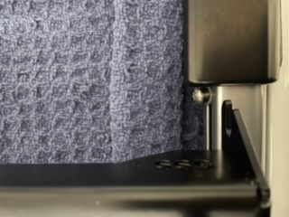

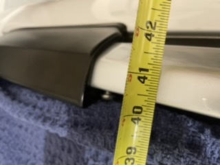

Yes, all rails are 40 and 1/2”. The distance between my rails is 40 and 3/8”.
I’m not an engineer. Please tell me what I’m missing?

I just measured mine - 40.5 and they work just fine.

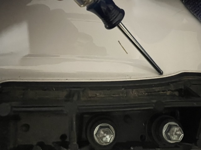

Loosening the rails worked. If you need to do this, don’t be intimidated. I do recommend plastic automotive trim tools when popping off the end caps.
I loosened all four corners (to be even) and laid the bars in. I tightened the bars in position, then tightened the rails back down. I only needed to move the rails enough to expose a little dirt that had collected under the caps. I’ll include some pics. Already added eyelets.
