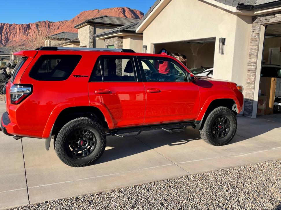

-TTBOSS-4R210ALM - Toytec Aluma Series Boss Suspension System (10+ 4Runner) 2"-3" Lift with SPC UCA's around $2300.00 very comprehensive kit,
installed mine a few weeks ago
