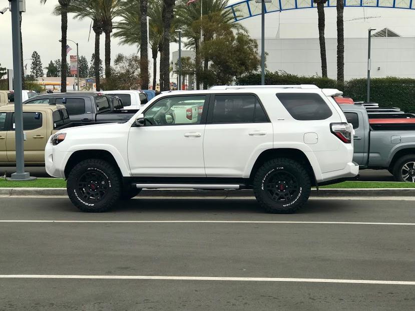

I have the Daystar 2.5/1.5 kit and have stock running boards.
