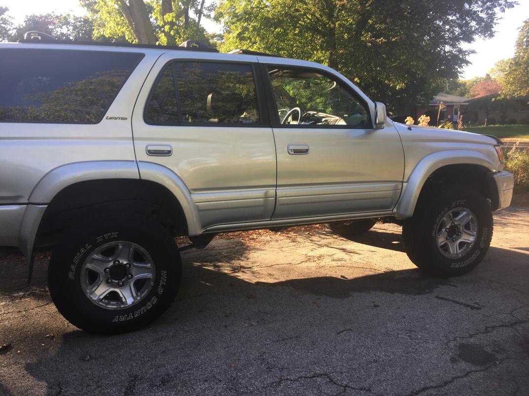

Horrible pics but it's all I have on my phone. Front setup is the same and rear is LC 7.5/8 wraps with oem tokiko black (LC) shocks. 265/75 tires. Super happy with going this route. Not sure how it will all be affected with armor but I'm not there yet.

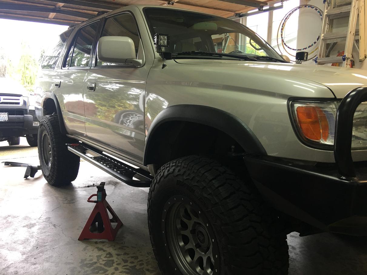

I’m also running LC 7.5 wraps in the rear with tokico blacks. Setup seems pretty good. I’m running kings up front with TC upper arms and the back definitely can’t keep up with the front. I’m running 285/70/17.

I'm diggin' your wheels! What are they? Have you had any rubbing issues! I'm planning on running a 285/75/16

Thanks! They are SCS Ray10s in gunmetal. No rubbing issues, I flattened the pinch welds and trimmed the inner fender liner a little and so far so good.

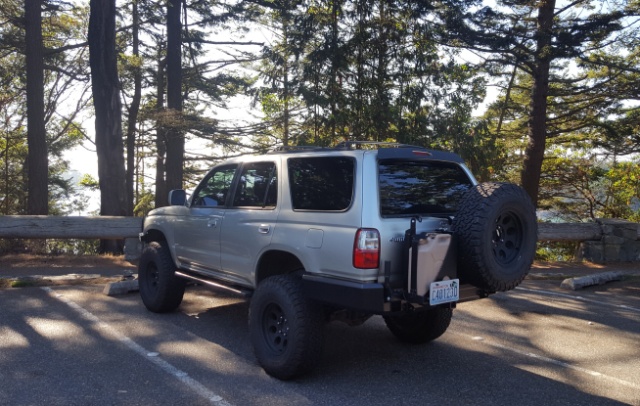

If your planning on a rear bumper w/swingout your going to want to go with OME 861's. A few guys are running LC 9 wraps with a rear bumper but most are running 861's. Unweighted they net 5" of lift. Weighted they settle nicely at 3 to 3.5. They carry the weight really well. Or you'll do what most of us have also done. Get 3" standard coils now then swap in the 861's when you get the bumper.

That's what I've found a lot of guys are doing the last couple days or research. I was thinking that I'll probably end up doing the same exact thing until I get weight in the rear. Thanks a ton for your help.

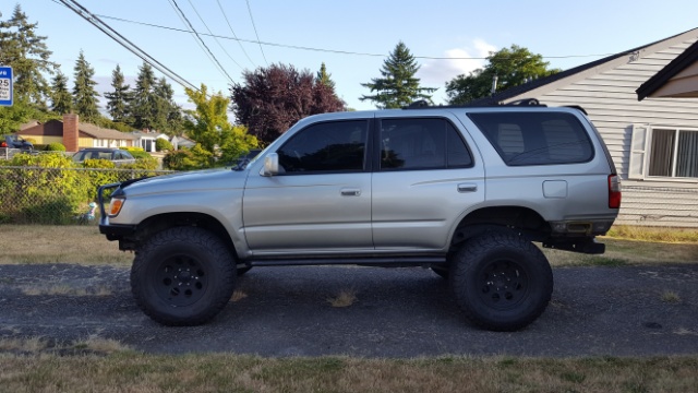

I would agree. My progression was tired 2002 stock suspension >> King C/O front LC 7 wraps Sonoran Steel rear lift >> after adding rear bumper >> 861 coils.
I didn't think, for the few days I had the 861 coils with no weight or even a spare in the back, that they were harsh.
Pic if empty 861s without rear bumper.
One with.
