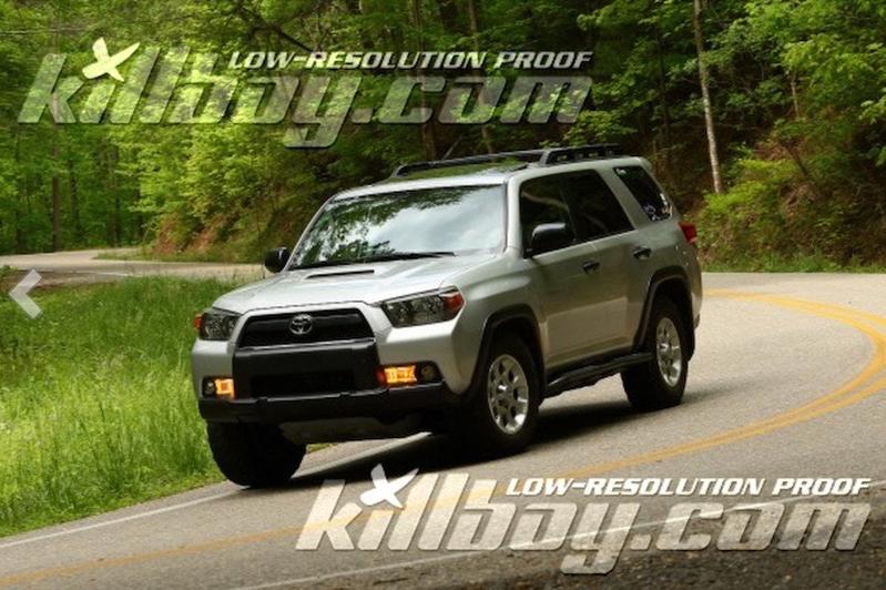

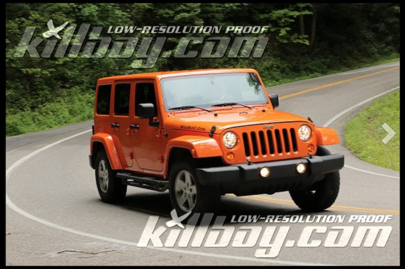

I can only compare my stock '12 JKRU and my stock TE without KDSS. Unless the KDSS works some miracles, get ready for a more top-heavy, more body-roll experience. They both handle decently in mild curves but the JK was much more level and stable as the tires start complaining. Then the 4Runner's stability control and brakes can get very weird when pressed hard in sharp curves, especially when combined with changing grades. Sometimes the 4R just does what it thinks is best and it will scare the crap out of you. The Bilstein 5100s have helped some with the roll. Overall, the Jeep was a lot more predictable in that type of driving.
For me, I always liked the style of the early Trails and the 4Runner was a debt-reduction move. It is more comfortable for everyday driving and does most of what the Rubicon could do. I really miss that Jeep, though.
I live in the mountains of East Tennessee and we have lots of great roads.:D
