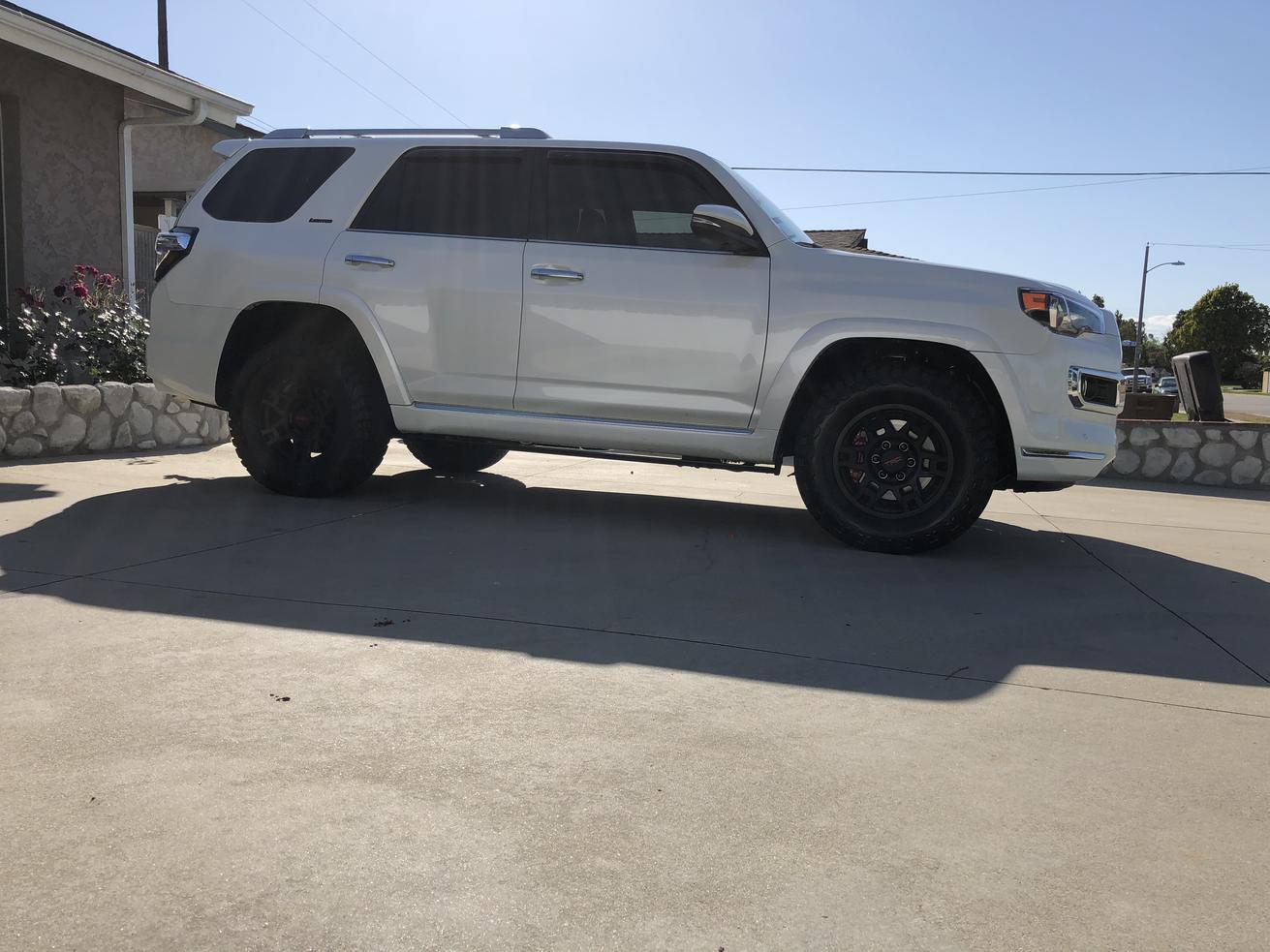

@DC4R - with an imperfect tape measurer attempt from the ground to the top of the roof rack seemed to be between 75''-77'' high.
@Mtn.Rush - thx
@Quentin - thx, my 2007 sport was setup the same way. factory wheels bfg's and a level kit. I think toyota would sell quite a bit of them if they came this way.
That looks real nice , loving the BFG's on it too. Congrats !!
How is the acceleration with the 285's ??

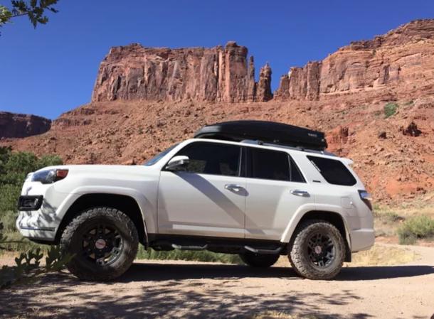

Planning to level my 2018 Limited with toytec 2” spacers in the front without messing up XREAS. Don’t really want to add additional lift to rear. Will these toytec spacers do the job? Thanks.

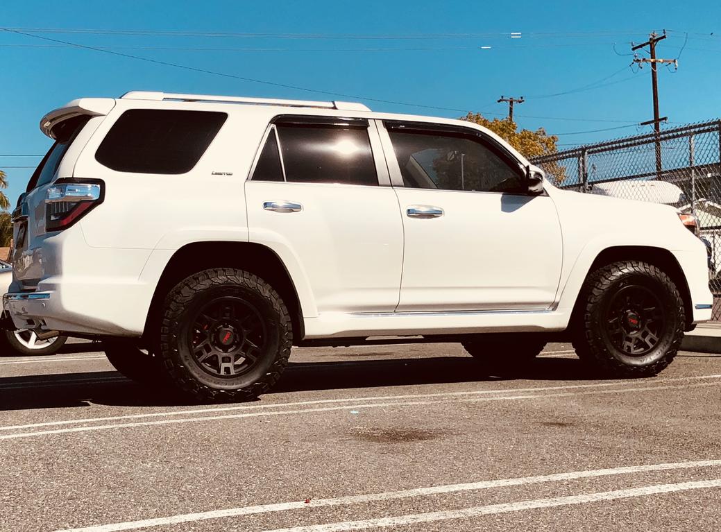

I have a '16 Limited and added a Toytec 2" (TAC-2) preload spacer in the front. After install, I quickly realized I had a slight reverse rake when fully loaded, so I later installed a rear 1" Cornfed spacer. Much better now.
Able to post any before and after pics? Was planning on adding any spacers to rear. Was awkwardly noticeable with just the 2” front spacers? Thanks.
Unfortunately, I don't have any before and after pics fully loaded. With just the font spacers installed, it was level and happy when sitting empty in the garage. But after a mulch run to the local hardware store, the reverse rake was definitely observable sitting parked and was easily felt when accelerating. Personally, I think a little rake is good, especially if you haul or tow - that's when you want it level.
