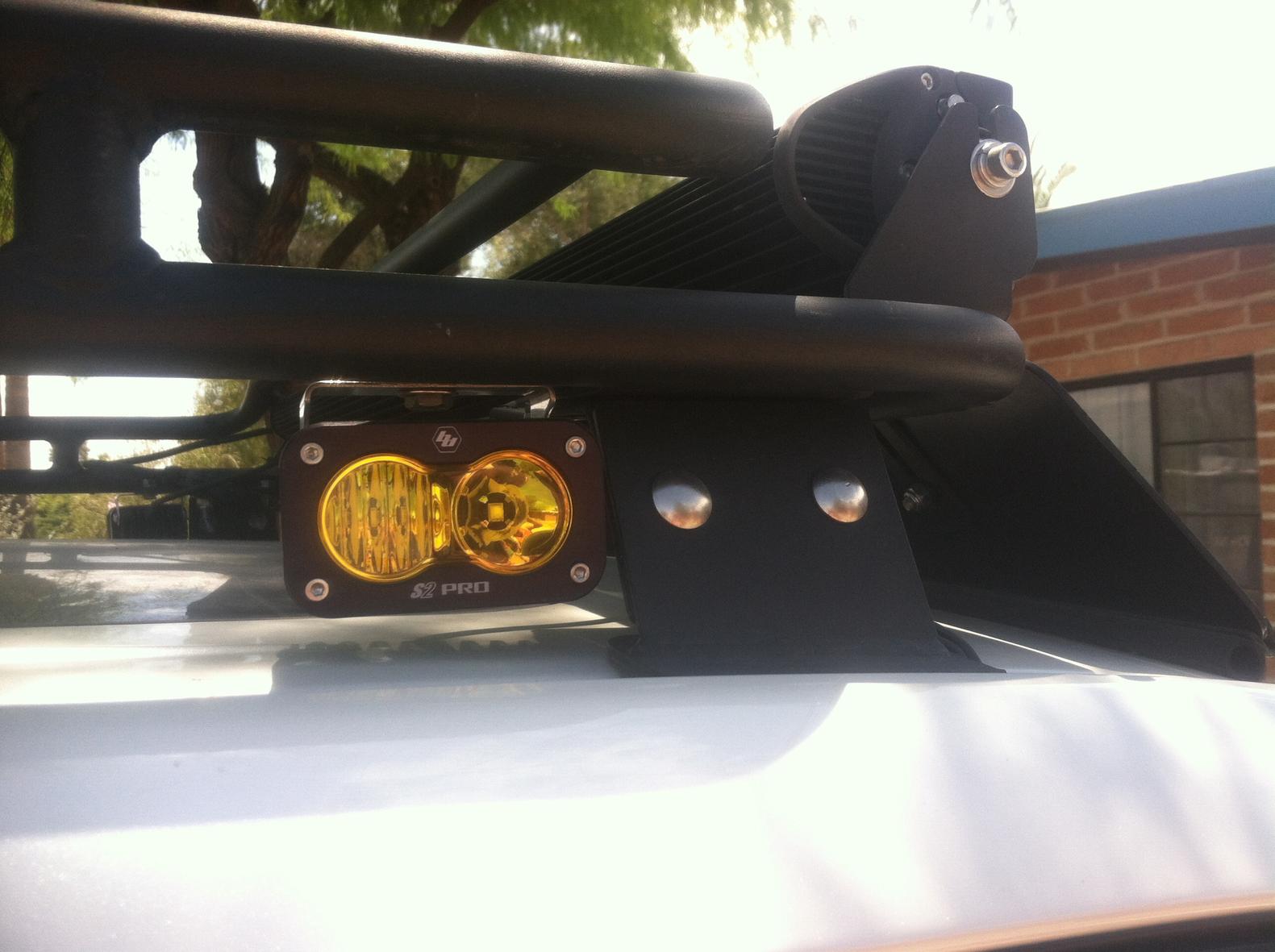

I use Baja Designs S2 Pros and mounted them on the front Gobi support bracket using an existing mounting bolt. What you see in the picture here is the passenger side mounted. I later drilled a new hole on the bracket a bit lower to compensate for the awning being in the way (only on the passenger side). The lights worked fantastic over the weekend at Death Valley when I was trying to find a camping spot at 1am

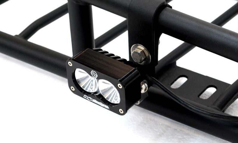

You can see one of my rear S2s mounted here using Gobi’s original mounting points. These lights are rear dust/fog lights only. As someone mentioned the mounting points are too recessed to throw any usable light directly behind the vehicle.
So the baja lights output enough light then? I have never seen them in person. I love how small they are.
Way more than enough. I actually have diagnosed night vision blindness and they work for me. Those tiny little S2 pros will beat out light bars that are triple their size.
In general Baja Designs LED lights are superior to anything out there including Rigid Industries. Yes, they are expensive but they put a lot of research in optics/reflection tech which makes them super efficient in throwing out light.
That's a great shot of Whitney!!

Would be nice if someone made a ratcheting / locking mount that easily allowed you to flip them up or down without tightening or loosening bolts. I have mine mounted on the platform but they don't work great for camp lights as they are too low/far back. Plus the Gobi ladder is in the way. Maybe if you had some real bright spots for backup lights or just general rear lighting for offroading. Still trying to figure out the best solution.

Anybody have a shot with the yellow Baja S2 switched on? Want to see how the lighting looks like
