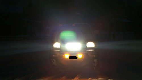

You probably can get a led bar with no flood light and all throw to compliment your headlights. I seen a jeep do it and it wasnt blinding at all.non projector hid in stock housing is worse at least with a throw led you can aim it.
