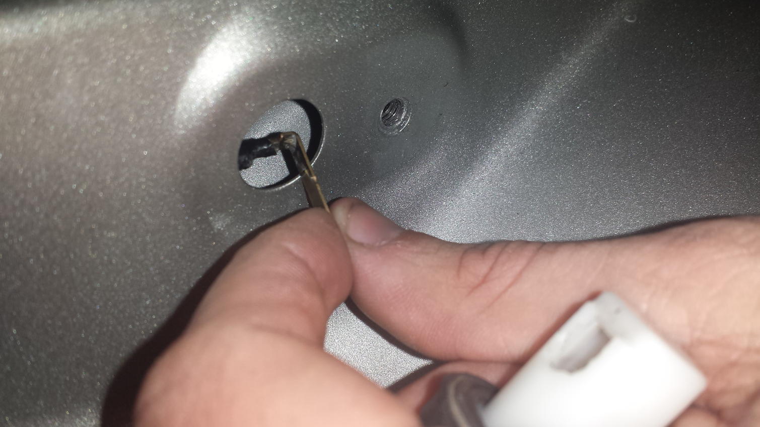

Decided to finally poke around and find out why my interior light wasn't coming on. This is the way I fixed mine.

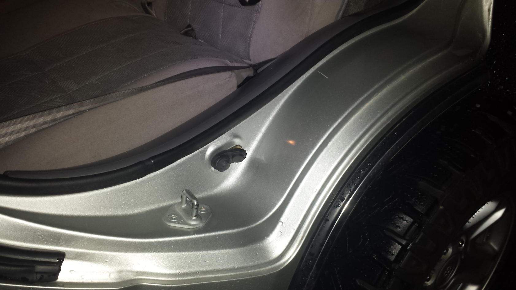

First locate the switch.

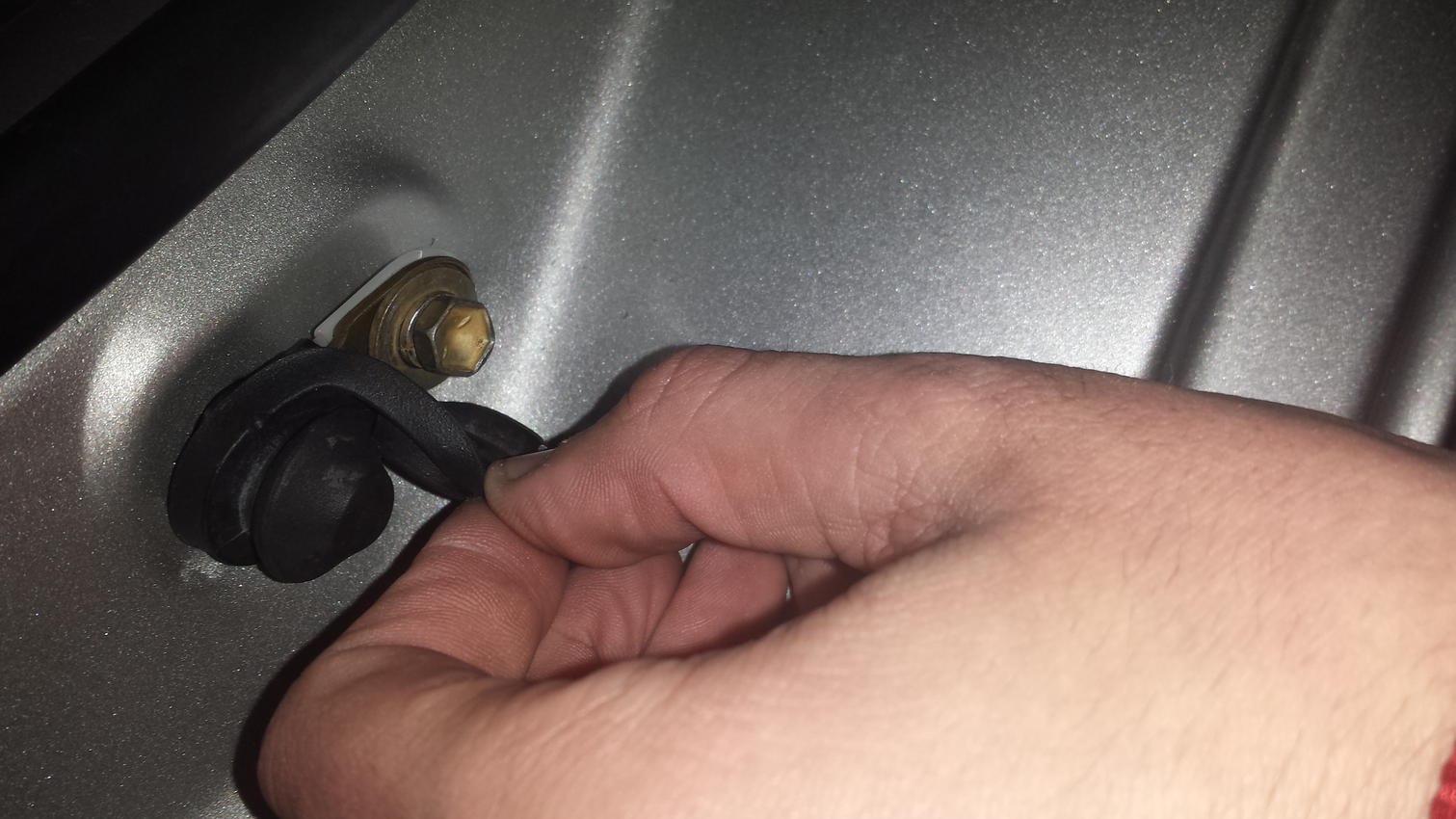

Remove bolt (10mm)

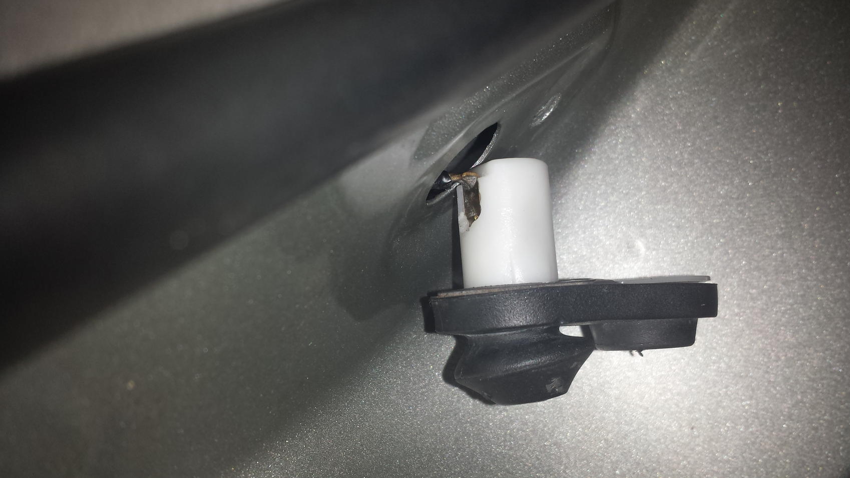

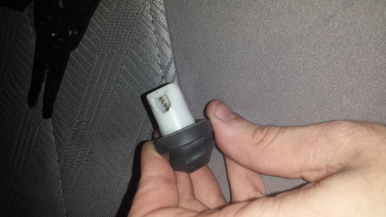

Inspect whether it is too far gone or can be salvaged

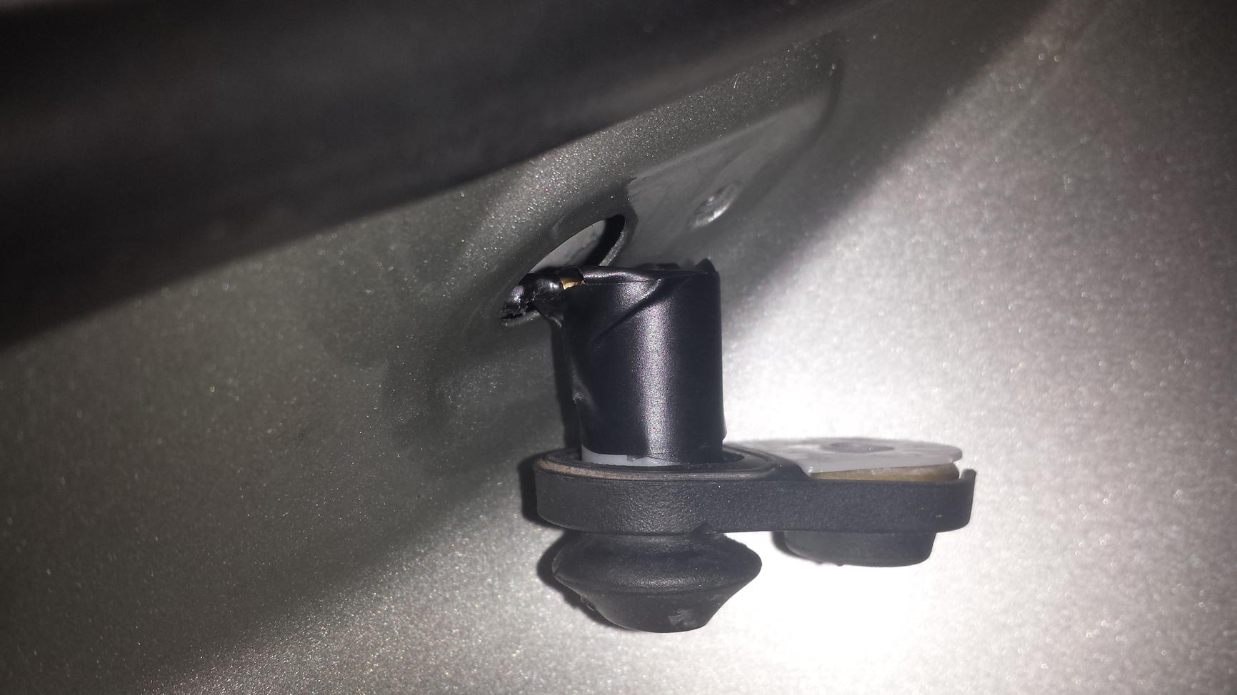

Mine was salvageable. I reinserted the connector then used electric tape to secure it to the switch

I'm glad im not the only one suffering with this haha!
But I can't tell exactly what you did/what the problem was? Did you re-solder the connection together or just add some tape or what? I don't get it.
Also, would it be a similar fix for the driver's door?
All of my switches seem to work perfectly except for the driver's door that works Intermittently.
just reinsert the connector into the switch. The problem with mine was that since the plastic cracked the connector was pushed out of the switch. The purpose of the tape is to prevent the connector from being pushed back out. So you are securing the connection to the switch. You can also go to a dealer and buy a new switch I'm sure.
Ya hate to say that wont solve anything,it eventually will fail.i did something similar that lasted a little than crashed. i ended up pulling some from a lexus sc300 out of a junk yard and they have been working fine for years.
