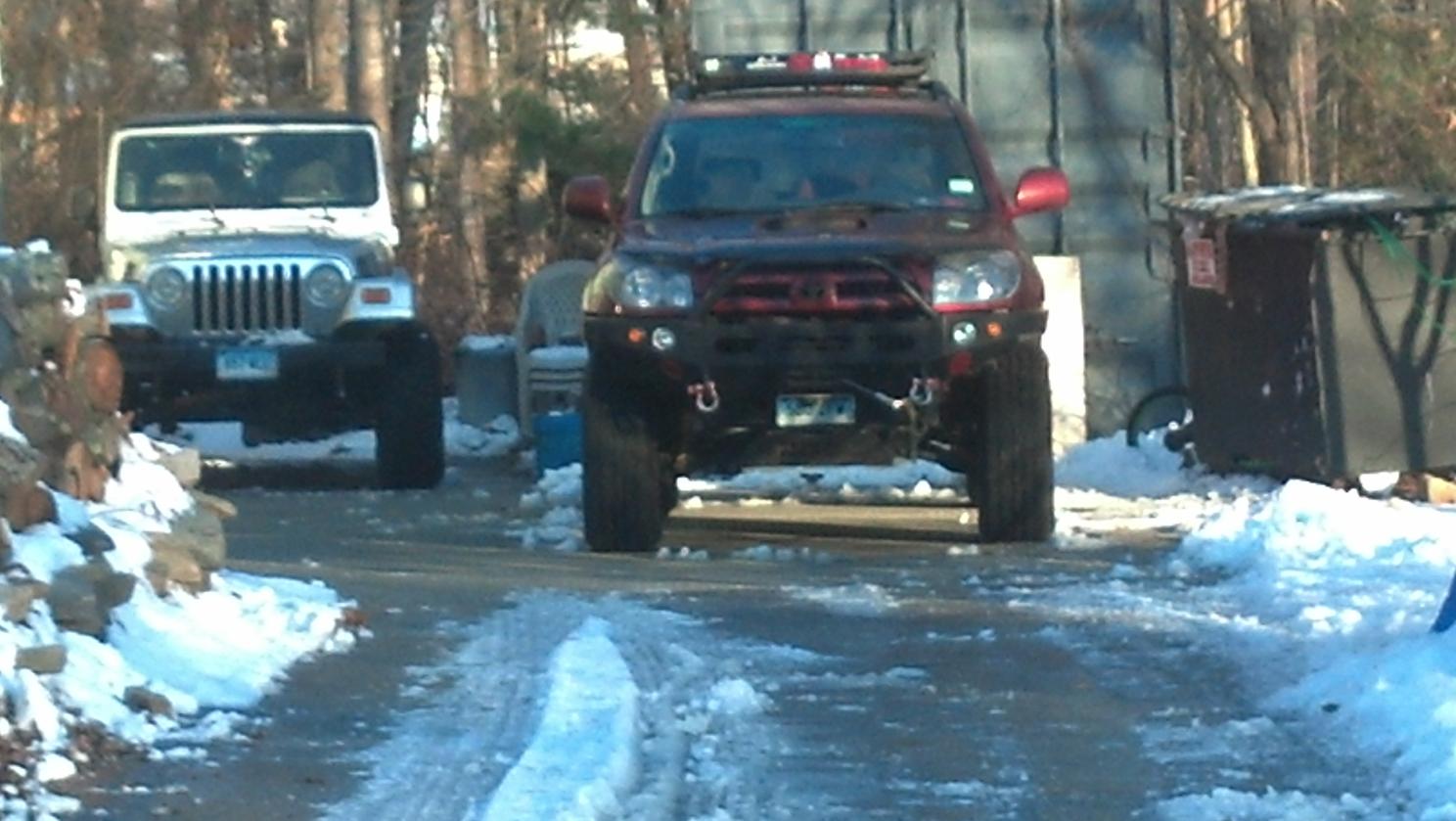

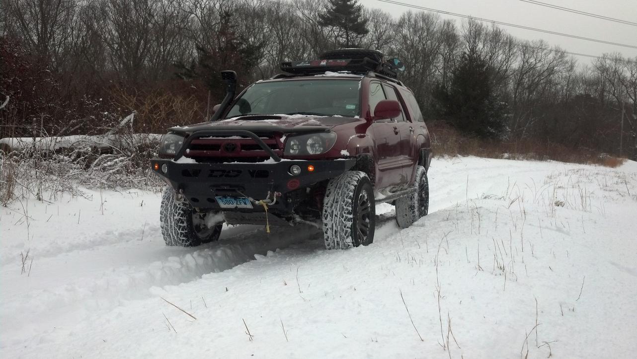

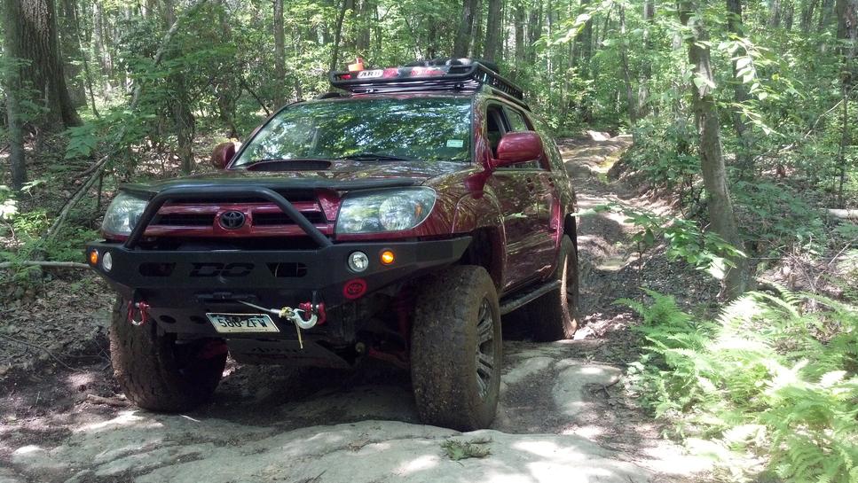

The demello is 80 pounds , its strong and ive hit trees and rocks with it going slow and it didn't budge. I don't think the airbags will be sffected since they use an accelerometer not a crush sensor. Here are some pics as requested.
