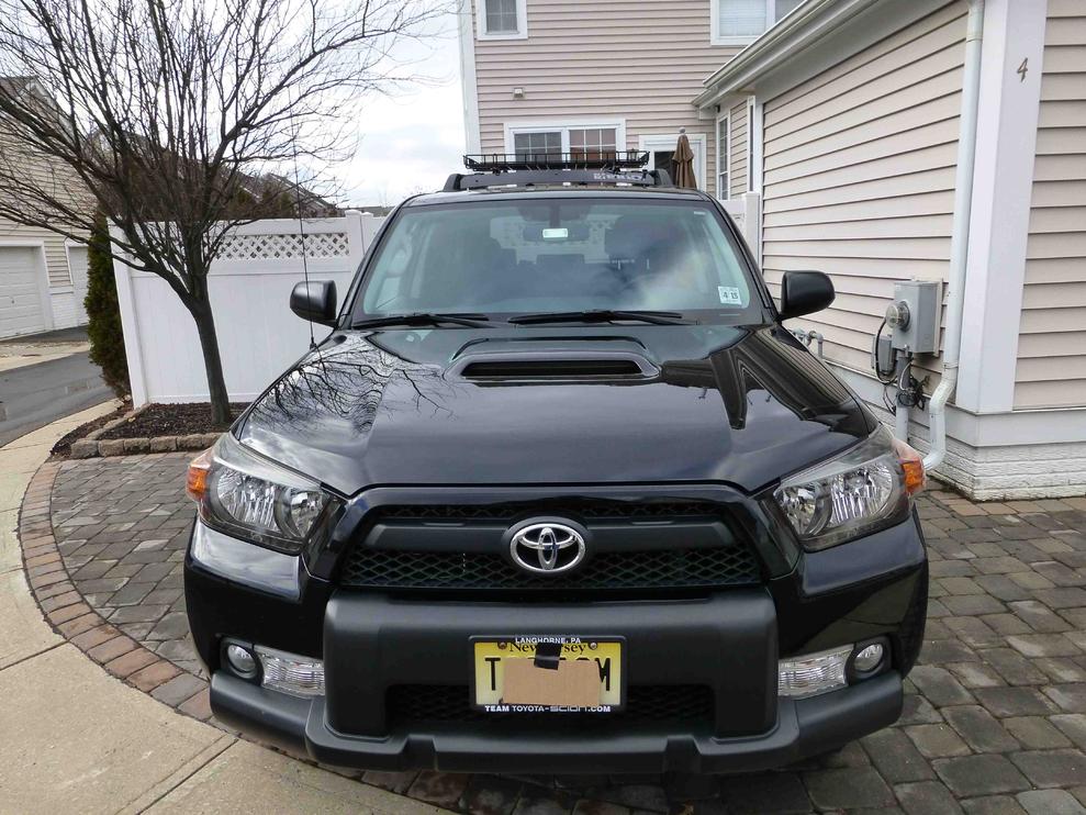

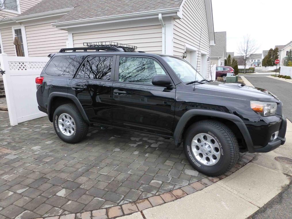

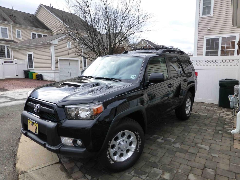

Thanks for all the input here this is very interesting. I prefer evidence base to placebo. I understand the theory in all this (but can’t do the math) but if someone swapped out OEM rims for those slick TRD's or Konig’s I like to know what that experience was like. I always try to balance price, performance and eye candy when making a purchase. Look forward to hearing what you guys have to say. Few pics...
If you click that link I posted and take the time to read it all your answers are there, you wont't need a calculator....
David
