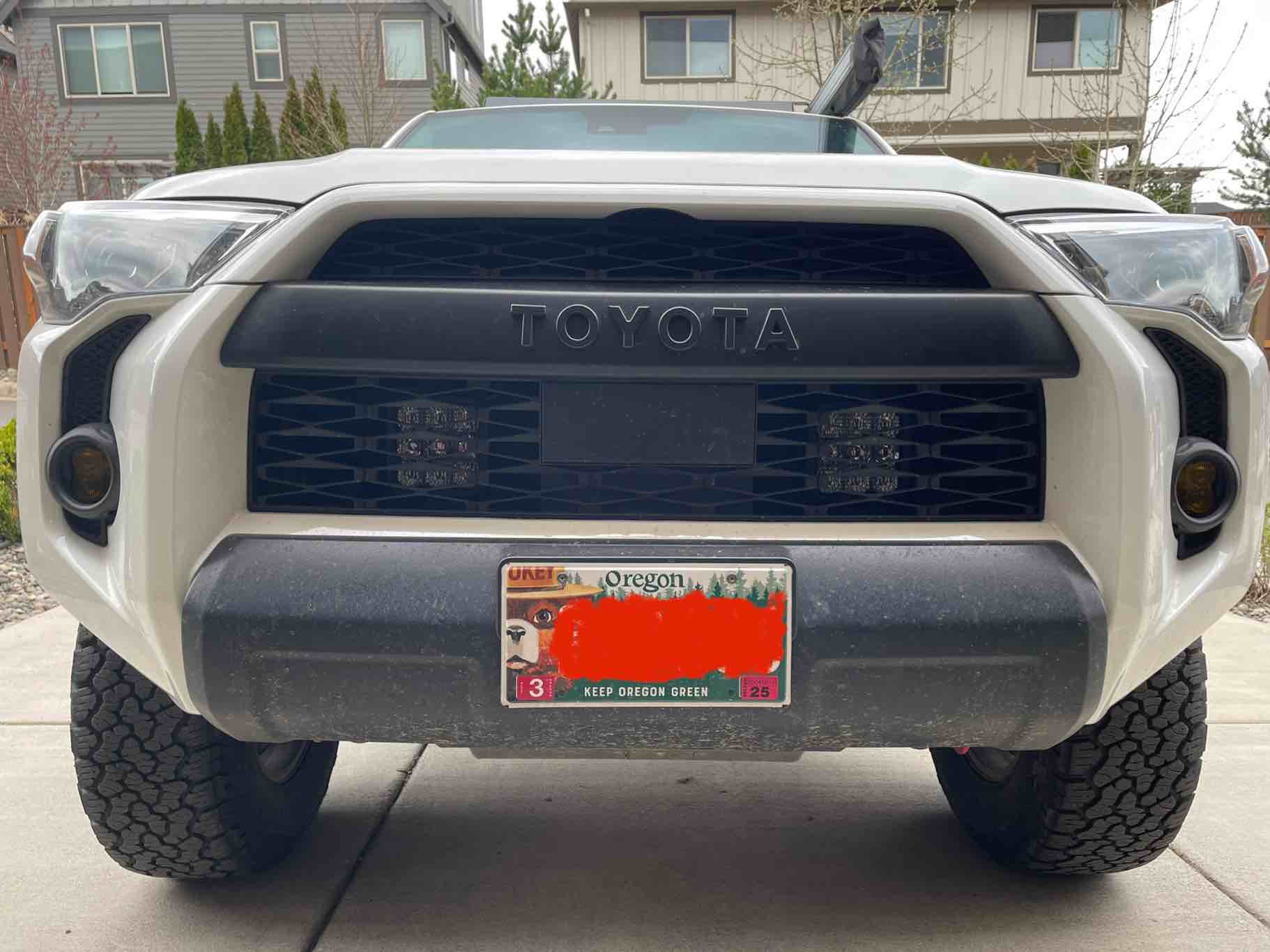

I recently took delivery of a set of Diode Dynamics new SS5 LED pods ordered from Hotshot Offroad. On the advice of crashnburn80 (in Tacoma World) who is a world-renowned expert on automotive lighting, I ordered them in selective yellow, but also ordered a set of clear driving lenses. This combination provides a warmer (less white / blue) color temperature which I wanted. These pods also have a kind of neat backlight feature and I'm running amber backlights hooked to the parking light circuit.
As for the installation, I again removed the front bumper cover and surprisingly, the cross bar in the Rago Fab mount did not have to be moved. I did have to reposition the SS5's laterally just a bit to minimize the grill blocking the new lights. (I also had to add a .250" spacer to get the height just right.)
How do they actually perform? Well, they totally blow away the OEM high beams and the Oscars. I have to aim them up just a touch, but here's what they look like on a dark street near me. Just a straight road, right?
Nope, there's a curve in the road about 150 yards out. Nice!
What's next? I have a set of Spot lenses on order and that should almost double the reach. Yes, power does corrupt.

As I've done with all of the previous high beam / long distance lighting upgrades on my previous vehicles, I wired the new SS5's via a relay triggered by the high beams with no switch in the circuit. I may re-think that decision though based on how bright these bad boys are. Can you imagine me inadvertently flashing my high beams at a police officer with these? Time (and maybe a ticket) will tell ...
I just installed 2x Pro SS5’s with combo lenses on the N-Fab mount, which I really liked. Need my AOB switch to be delivered so I can finish install.IMG_4248.jpg
