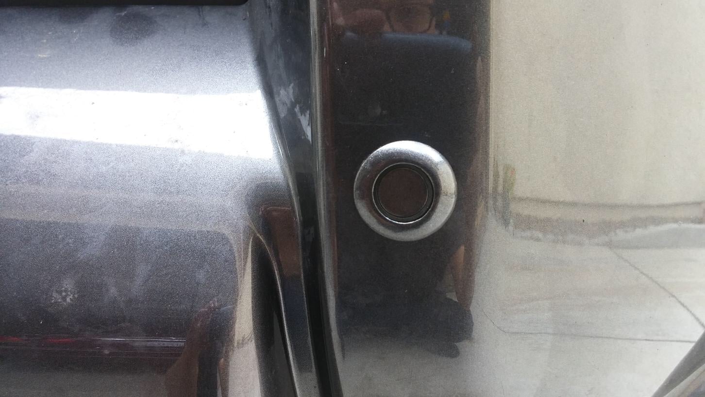

Where are your pics! I know you did the conversion but haven't shown anything! :). I put my sensors a little differently than straight on. Wanted to get alerted more towards the side.

It’s pretty straight forward. Drill the hole where ever you want but not exceeding the existing sensor distance between each other. I believe for the rear, it may have marking behind the bumper shell but if not, just drill 2 holes in the front and 4 in the back. As for the front, if you drill where I have have it, you’ll have to notch out a couple of inches of plastic trimming behind it to clear the senor itself. Otherwise, you can find another place above, below or to the side of it.
