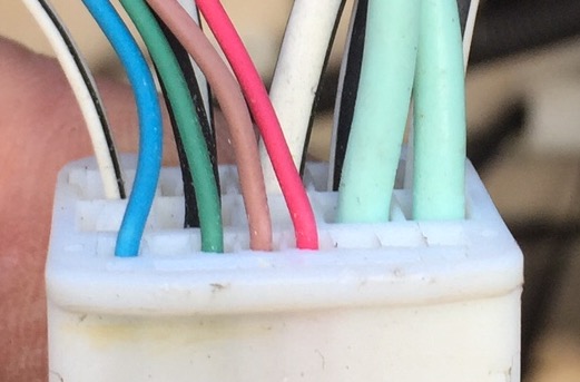

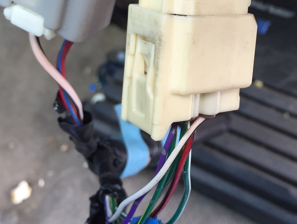

Here's a pic of my SR5 floor harness wires at the seat junction (power and ground wires at left; seat belt, seat track air bag sensor, etc. wires at right). I understand that a couple of the wires on the right are different colors on the limited harnesses).

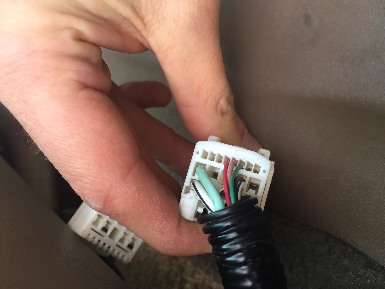

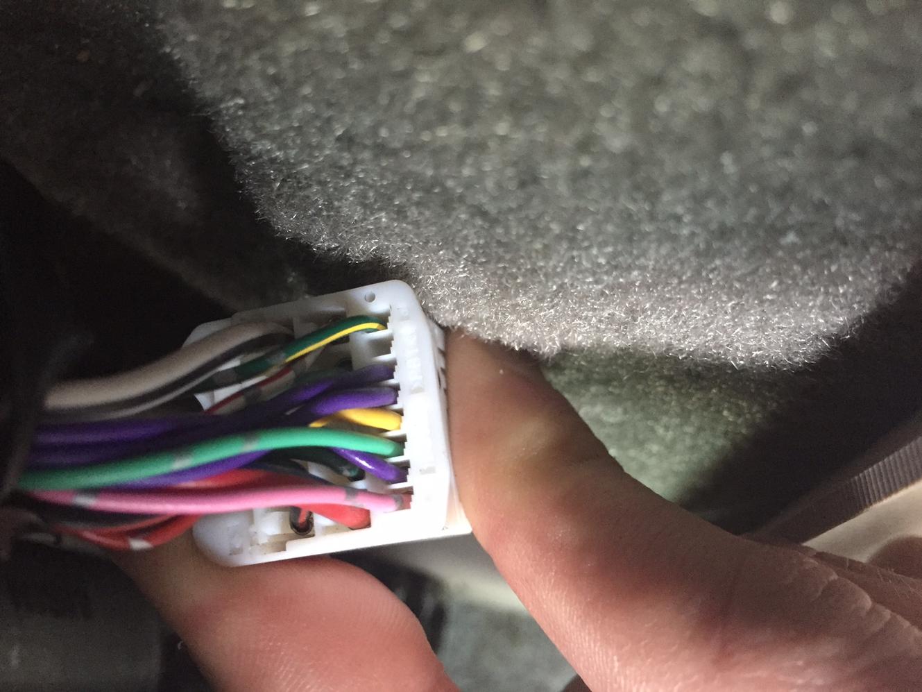

And the seat wire harness side (power are 2x thick light green wires, grounds are 2x thick w-b, not sure about rest).

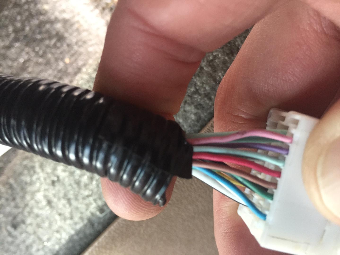

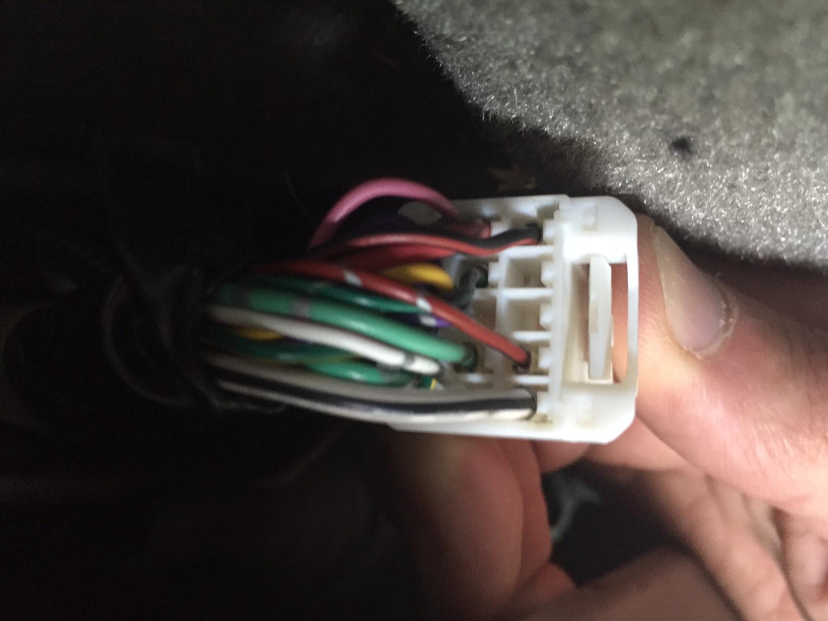

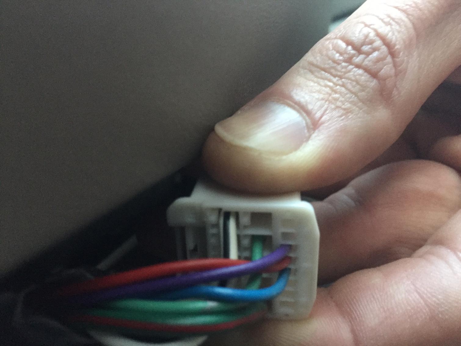

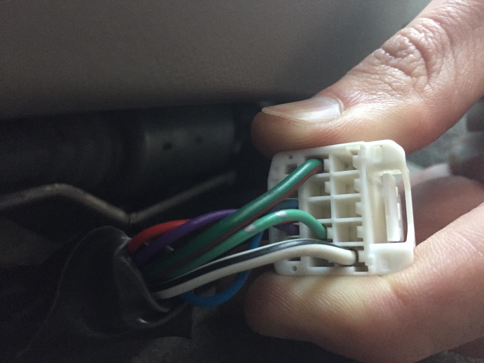

Here is the Driver's Side Seat connector.

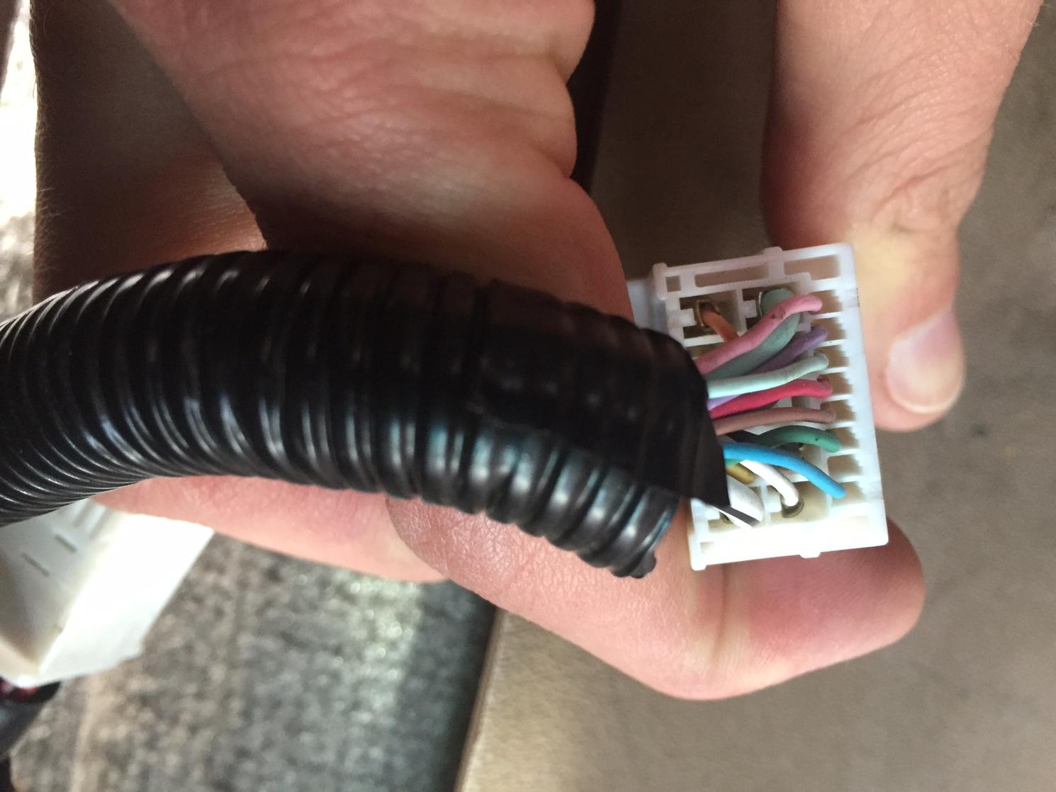

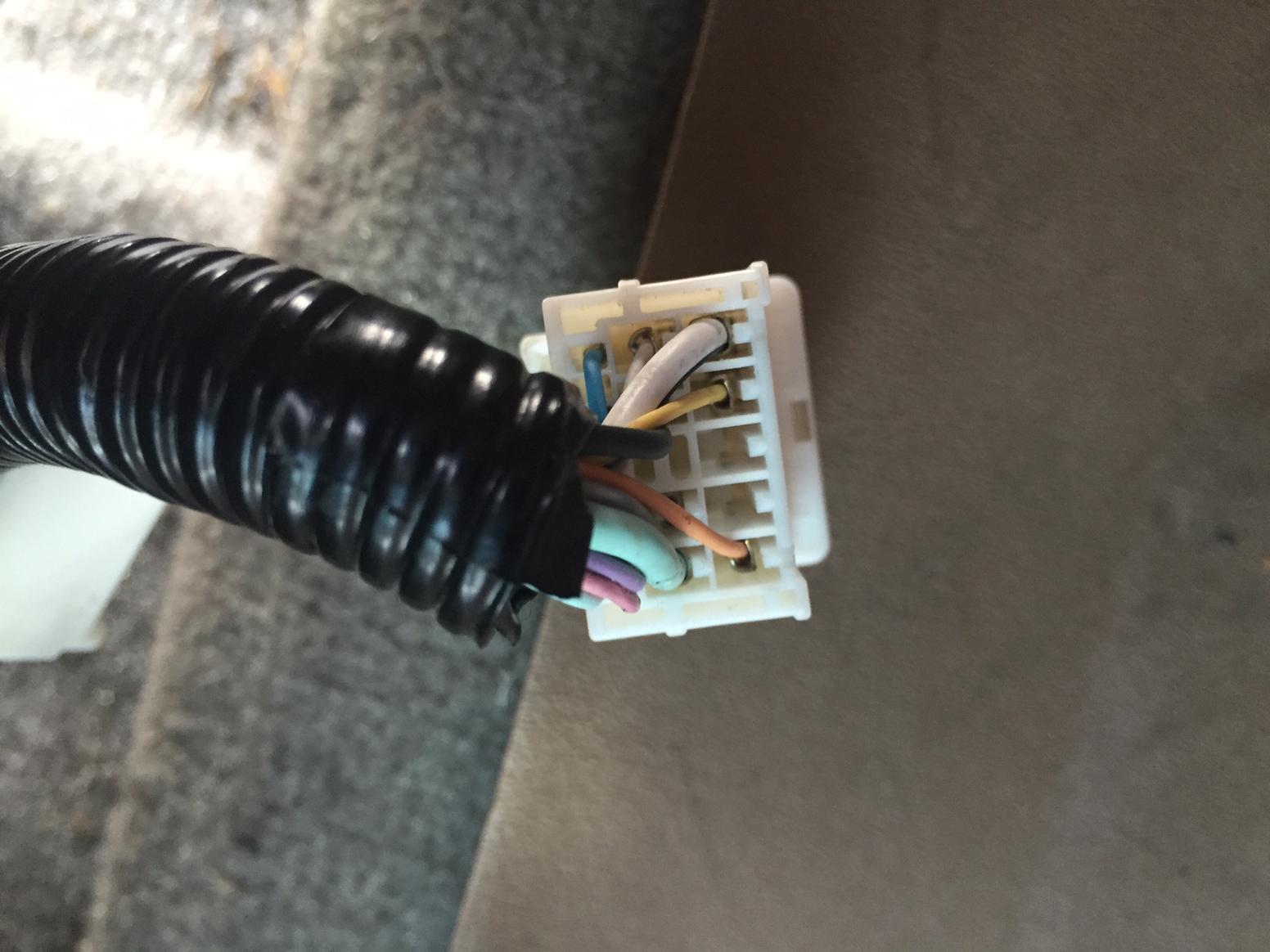

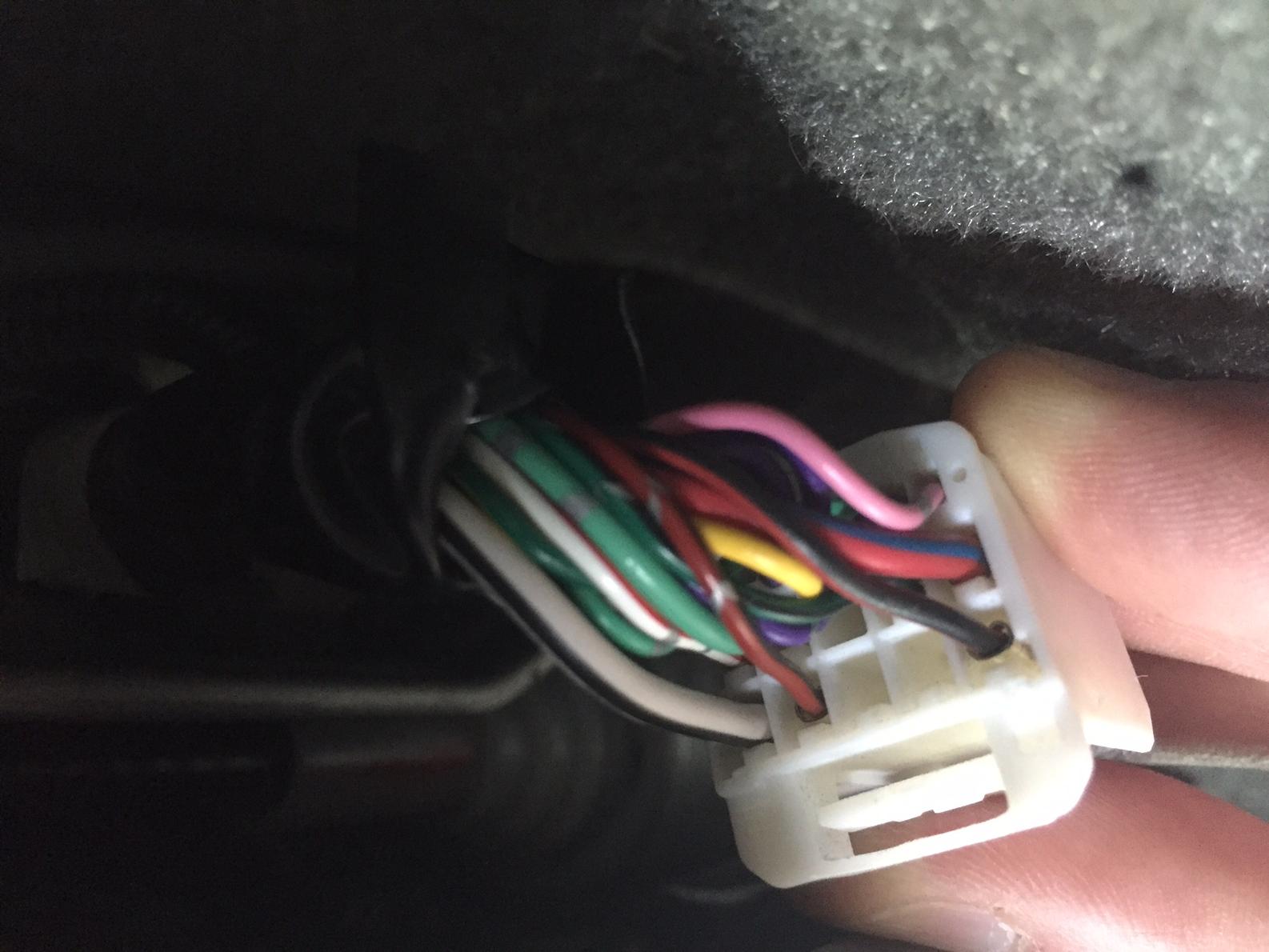

And here is the Passenger Side Seat connector.
If you are indeed looking for pics of the vehicle harness side, which I now think you are, I'll have to get those to you tonight or tomorrow morning. Gotta burn up the road for work now, but hopefully this gives you something to look at and ponder in the meantime.
IIRC, I had to get the harness from the IRC 06 limited I salvaged along with the heater switches and fuses from under the hood for the seat heaters. Worked great in my 03.

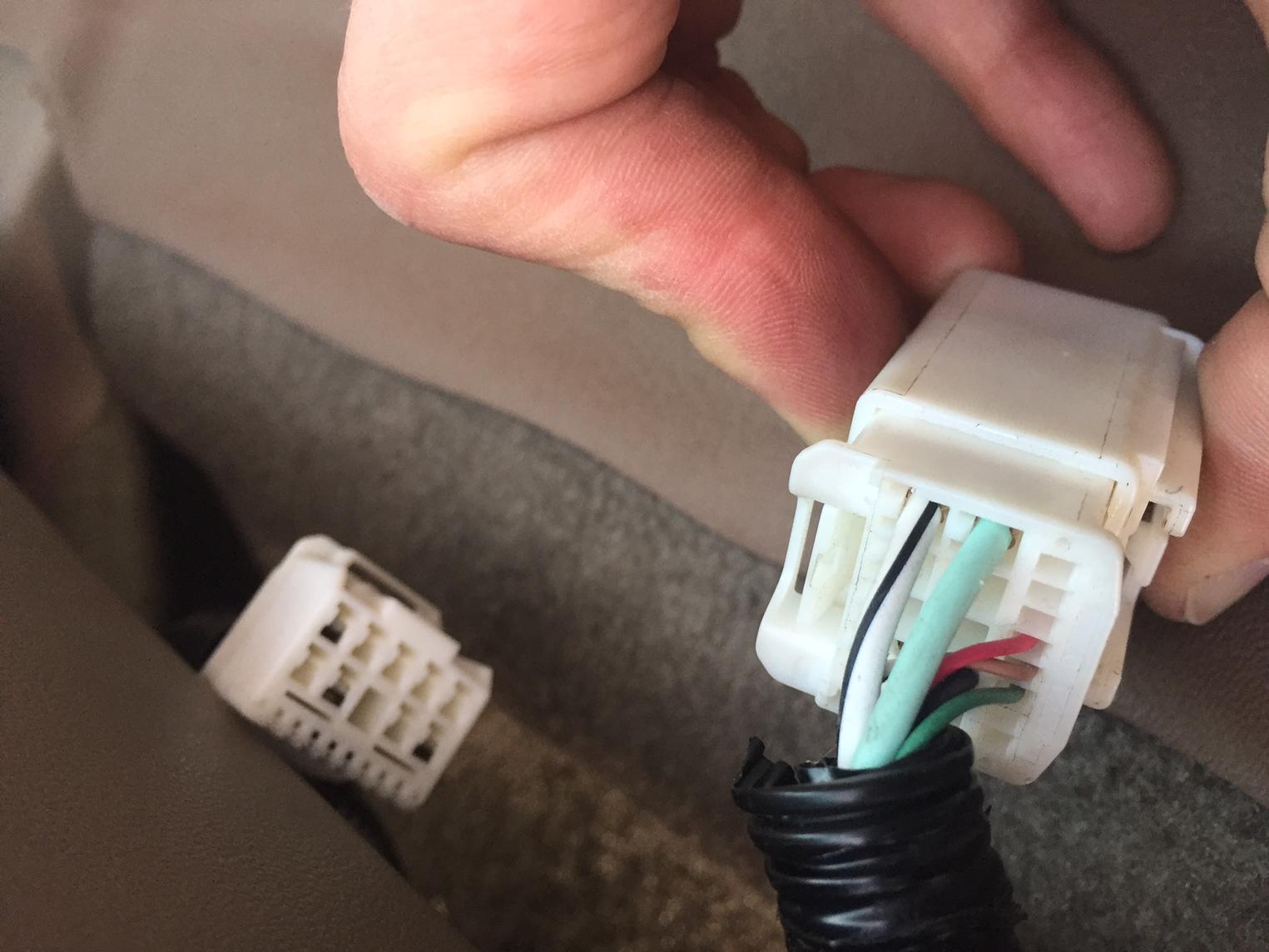

[MENTION=18304]pearlj10[/MENTION] Here are pics of the vehicle side connector for the driver's seat.
