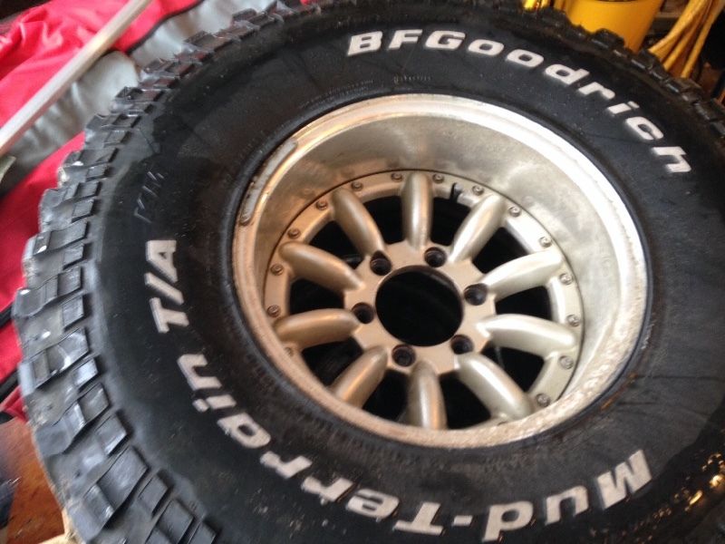

I am about to pick these bad boys up: $_20.JPG
Rims are 15's. They wont fit my limited calipers. will I be able to bolt on sr5's?

Are you saying bolt them to an SR5 brake system rather than a limited? Should not be able to, at least, my SR5s came with 16" brakes like the limiteds.
There are some 15" 4Runner brakes, is that what you're saying- you want to replace the 16" limited brakes you have with so you can bolt on those wheels?
no offense but id keep looking. The sr5 and limited brakes are underpowered as it is, downgrading would be taking a few steps back. The tires may be nice but not worth in IMO.
Sorry for the lack of info
Well I really want these rims, and I know there are earlier sr5's that came with 15 inch rims, so rotors and calipers would be smaller to be able to fit smaller rim. So I want to downgrade my limited calipers and rotors to smaller sr5's, I don't want to get into some insane changes so if smaller sr5 brake system will bolt right on, I am on the market for smaller rotors and calipers. Thank you.
sr5 and limited are the same and neither will fit 15in rims. You will have to get base models calipers from the models that came with 15 in rims and if those tires are 32s or bigger its going to have some hot and warped rotors. But if its really what you want it can be done, just not ideal or practical.
