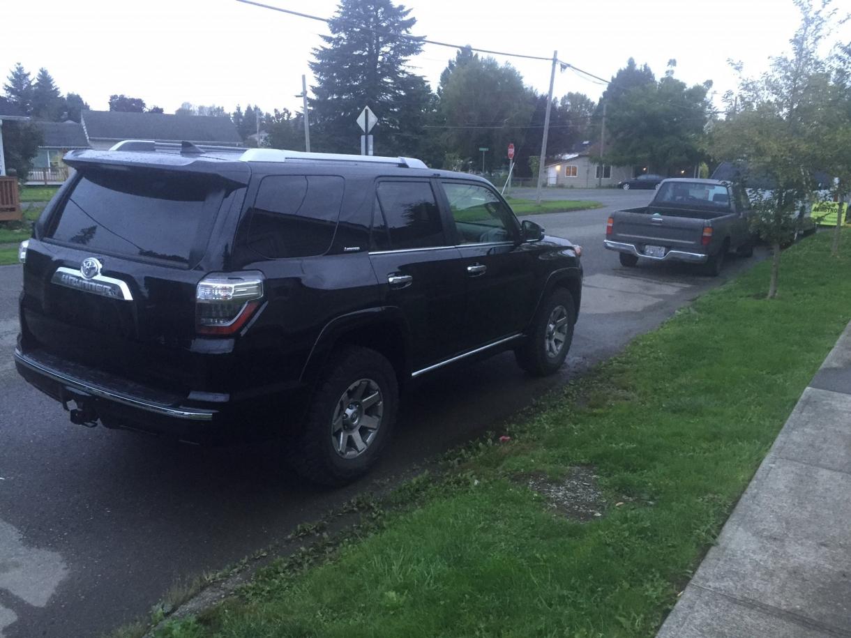

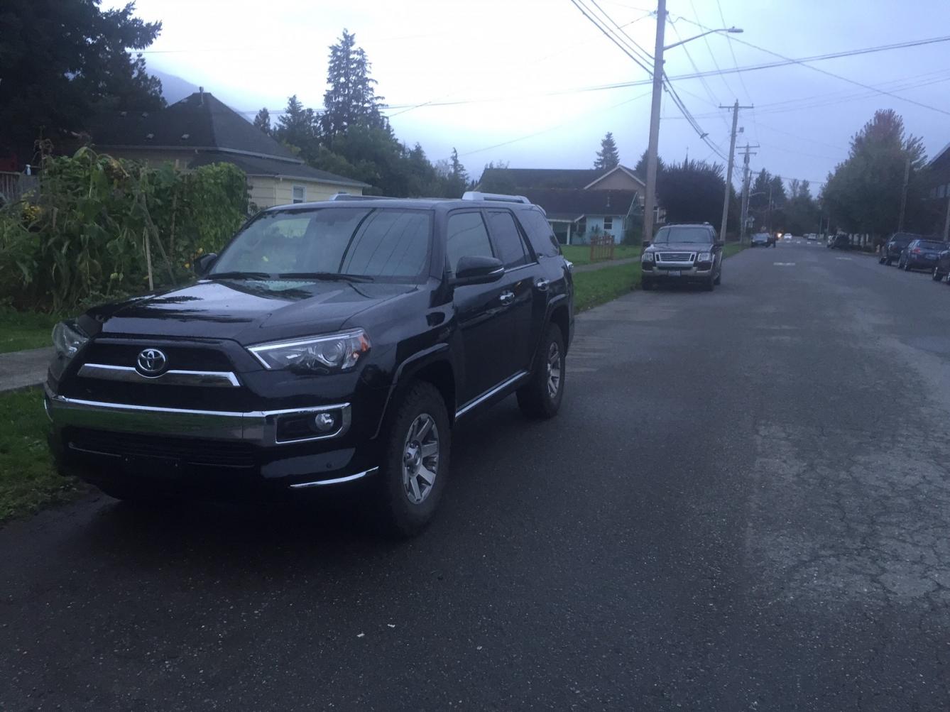

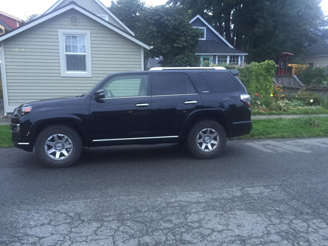

Not necessarily true. 285/70R17 tires fit just fine on my stock 2016 Trail (mounted on trail wheels) with no rubbing at all, but I thought they looked stupid. They're too wide, and don't look proportional to the vehicle. I've said it before, but 285 or 295 width tires on a 4Runner look like a little kid playing dress up and wearing their parents shoes.
I currently have 275/70R17 BFG K02's (mounted on Trail wheels) on my 2019 Limited, and I don't have any rubbing. I wish someone made a 265/75R17 tire, because I would run those in a heartbeat. I like the Trail wheels, but I'll eventually go to 18 inch wheels for winter and summer so I can run a 265/70R18 year round. A taller, stock width tire is both the most practical and most aesthetically pleasing option for these trucks. But I know opinions are like sphincters and I'm in the minority with mine around here.
I can try to take some better ones, but I do have a couple that should give you some idea of how it looks. Sorry for the crappy lighting. The truck has ~200 miles on it, so this is the factory alignment. I haven't gotten out calipers to measure the space between the sidewalls and my UCA, but I can slide my hand in between the two, so I would estimate there's just shy of an inch of clearance between them.
I'm not saying you're lying, but I have an incredibly hard time believing this. You must have a unicorn of a 4runner then. I'd put money on 99% of stock 4runners (if xreas, at stock height) rubbing while rocking 285/70/17 on the OEM rim.
No rubbing in any way, shape, or form? Even at full articulation and in reverse? Even at full compression?
Guys running 3" lifts running 285/70/17s still rub so that's why I have trouble wrapping my head around this. If you don't rub, you're the only person I've come across on the internet running 285s on a stock 5th gen that didn't rub. In which case, without a lift, if would look absolutey goofy, I agree lol
Lift height does not effect tire clearance, for about 700,000th time.
On my Limited, I believe 285's would likely rub, but on my 2016 Trail, with stock Trail wheels, they did not.
I had 285 KO2's on it while I lived in Colorado and drove the Alpine Loop, Lead King Loop, Mosquito Pass, Imogene and Black Bear Passes, some mild Moab area wheeling, and general FS road use with that setup. I never encountered rubbing issues with the the amount of flexing required to do that sort of off-roading, which is honestly the most rugged terrain I'm willing to drive a new $40K+ vehicle on.
Also never had it realigned in the time I owned it, FWIW.
