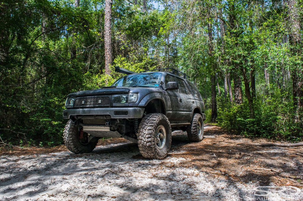

Here's a link to the MCM Fab kit that I sell:
https://www.srqfabrications.com/product-page/96-02-4runner-long-travel-suspension
