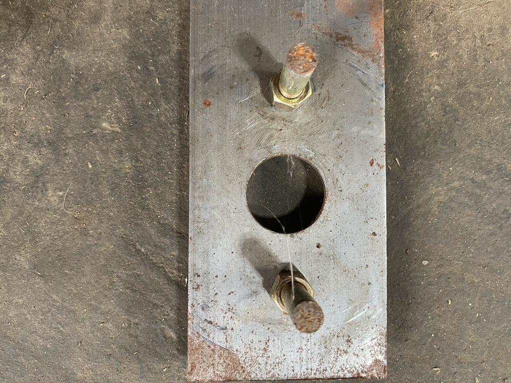

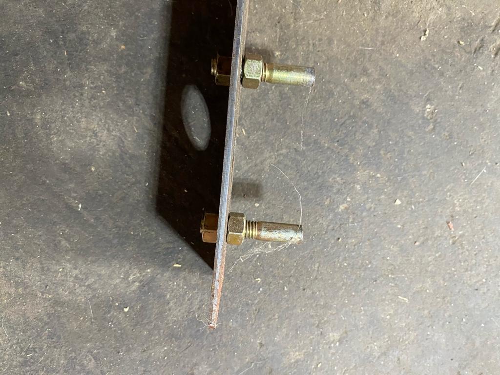

This is my holder. All hardware store items and 3ft long.

I have the tool itself covered, but it's the inner ring of the harmonic balance itself that's now spinning loose. It's the part that has the two holes that receive the tool you illustrated.
