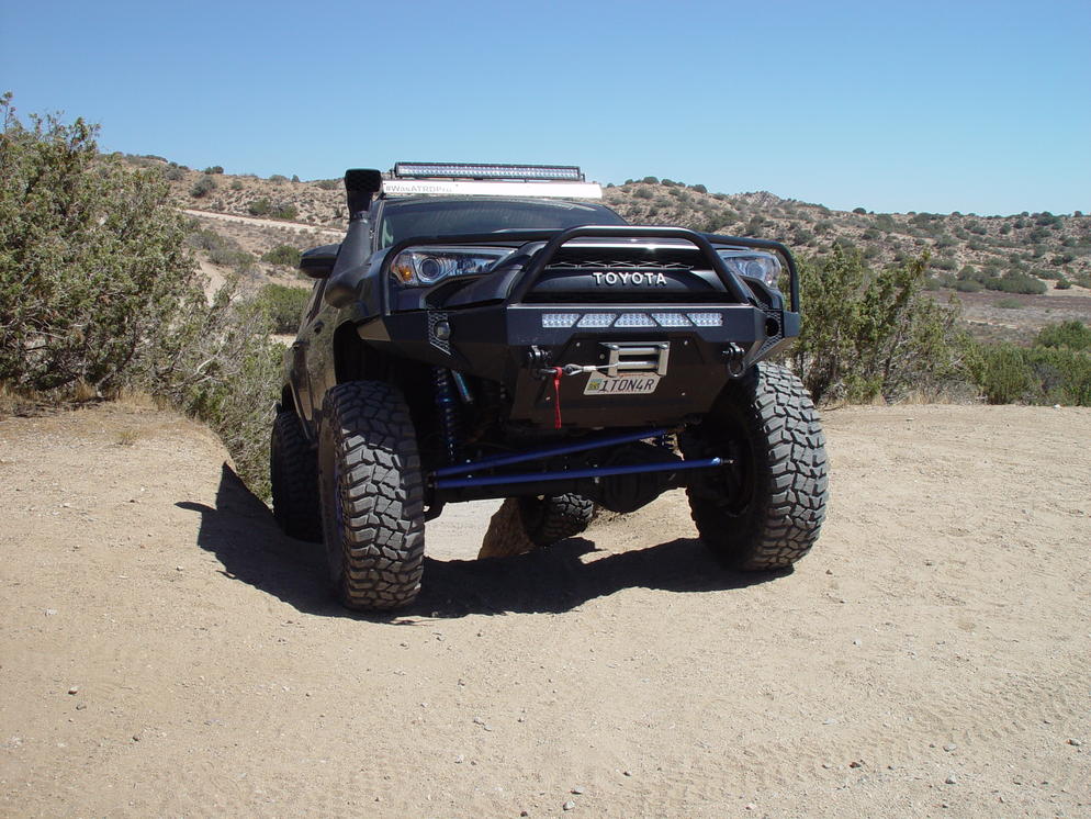

i have a cheap 30" one I bought off amazon for 30$, fits and looks great on my 2016 4runner with cbi front bumper and winch installed

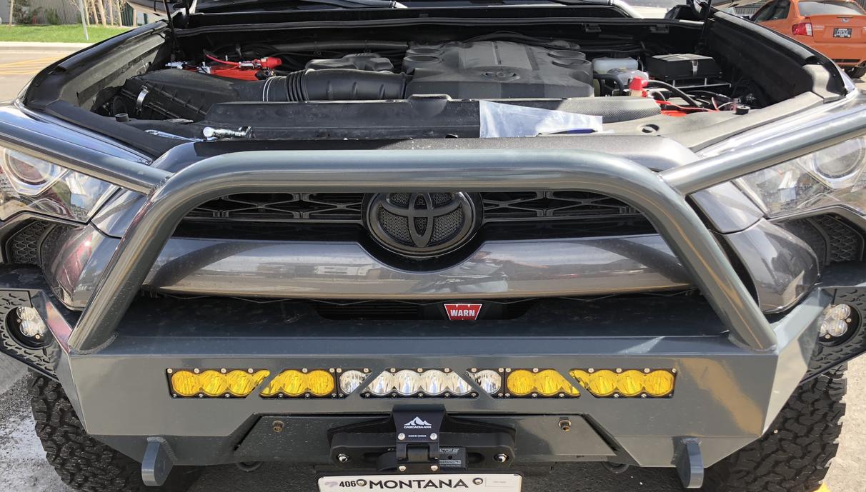

Just finished installing my LED light bar in a CBI front bumper. I have a Baja Design OnX6 Dual control 30" light bar. I also have a Warn M8000s winch. The dimensions here are about the biggest light bar you can use. It just fits in all dimensions but works really well. The dimensions are 30" x 4.29" (deep) x 2.69" (tall). Hope this helps. Pictures attached.

No I didn't document the install (sorry). Its such a tight fit I did have to pull the front bumper off to get into that space rather then just the front access hatch where the winch fairlead is. The bracket the comes with the lights sits right into the bumper as CBI has space for it. Very easy from there. There are two separate wiring harnesses (one for the clear, one for the amber). I have an SPOD so I just had to run the two wires to the SPOD so wiring any accessories is really easy. I wish I had pictures for you. I'm sure somewhere in the forum there might be install pics for an LED in the front bumper of a CBI, I'm sure they are all similar.

What mounting brackets did you use. I just got a CBI front bumper and have a S8 Baja Designs light bar. When I mount it with the BD mounts it sits back from the front plate about 2".
