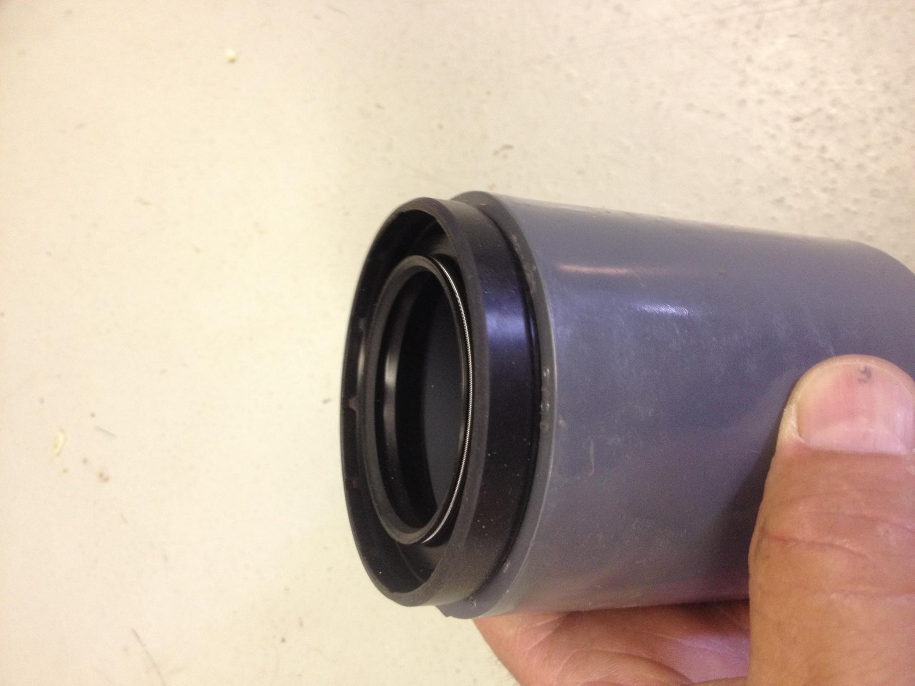

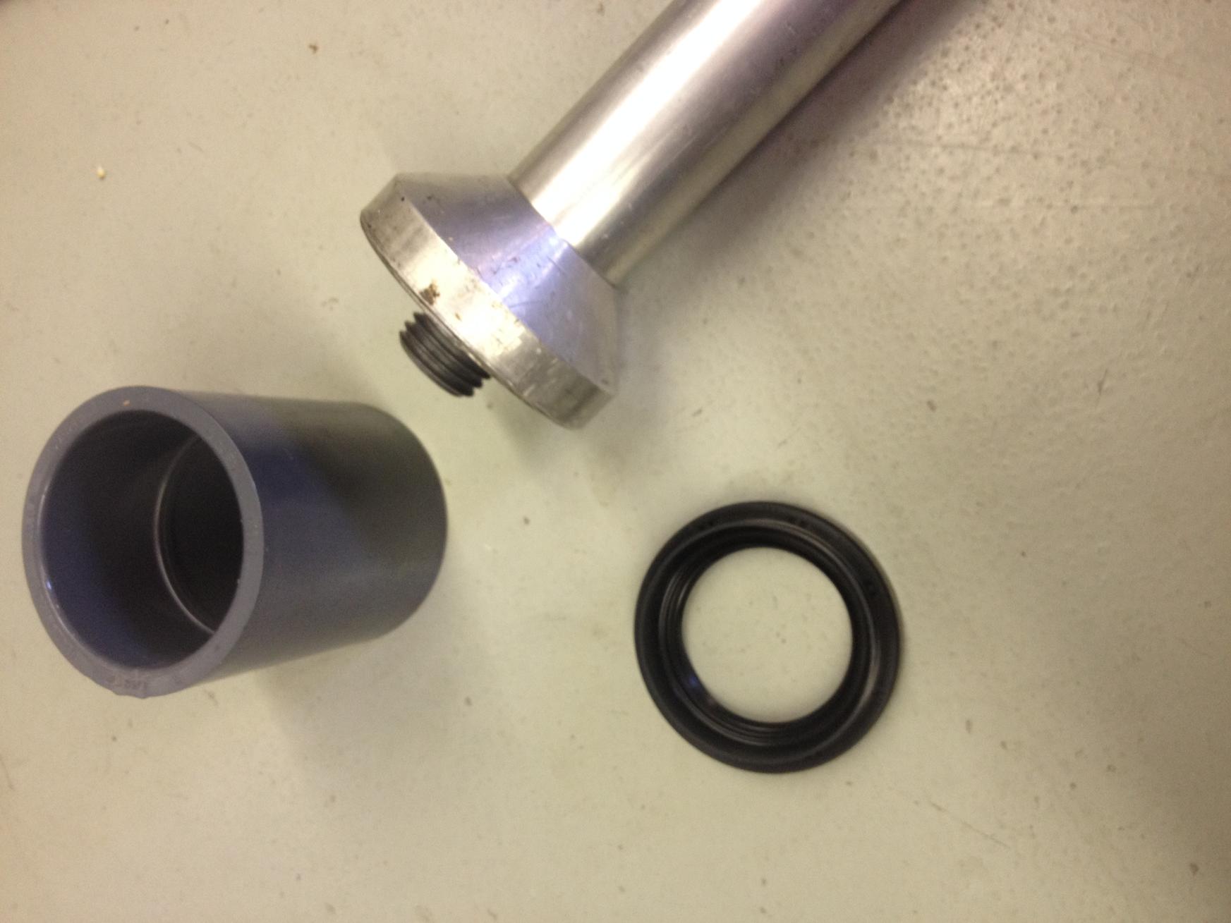

I found that the dimensions of a 2" PVC schedule 80 coupling are the perfect size for installing the center differential seals on my '03 T4R. The PVC is soft enough not to damage the seal but hard enough to get the job done. Be sure you use the schedule 80 fitting, the normal schedule 40 is smaller.
