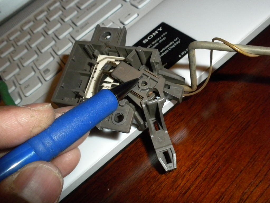

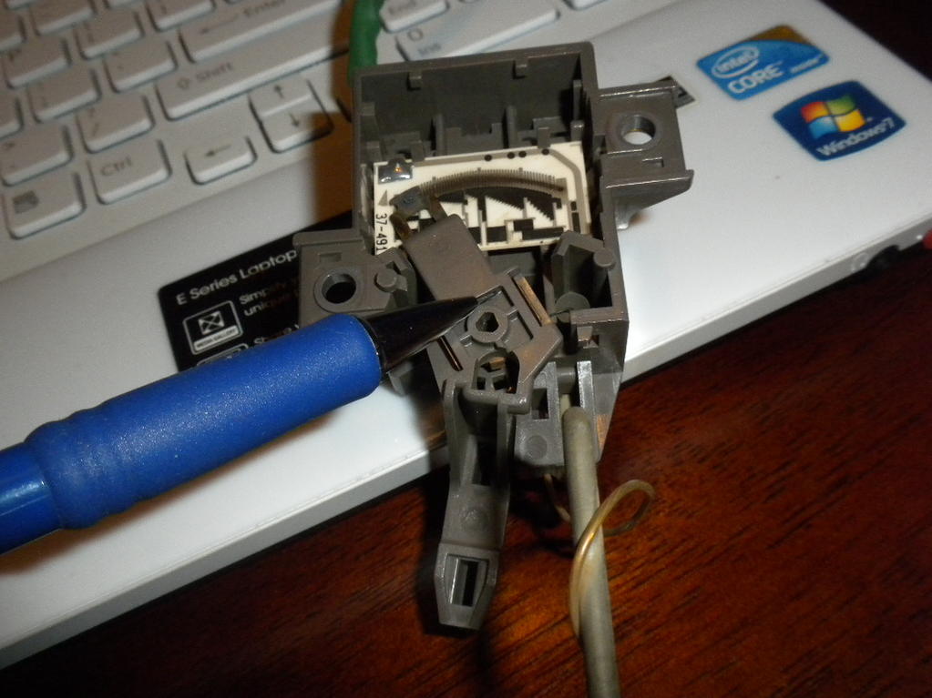

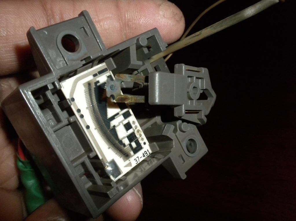

There is a floater attached to a metal rod, which is then connected to a plastic lever that runs on a resistor pack.
The plastic lever is held in place by a soft mechanism. It may be stuck. If you don't want to lower the gas tank, Just continue to run with half a tank of gas and with few bump, you might get the floater unit to function.

Thank you so much guys, nissanh thx man pics are very informative. I tried running it low and going over bumps several times but it didn't help, guess i gotta drop the tank. Hopefully its not too hard
