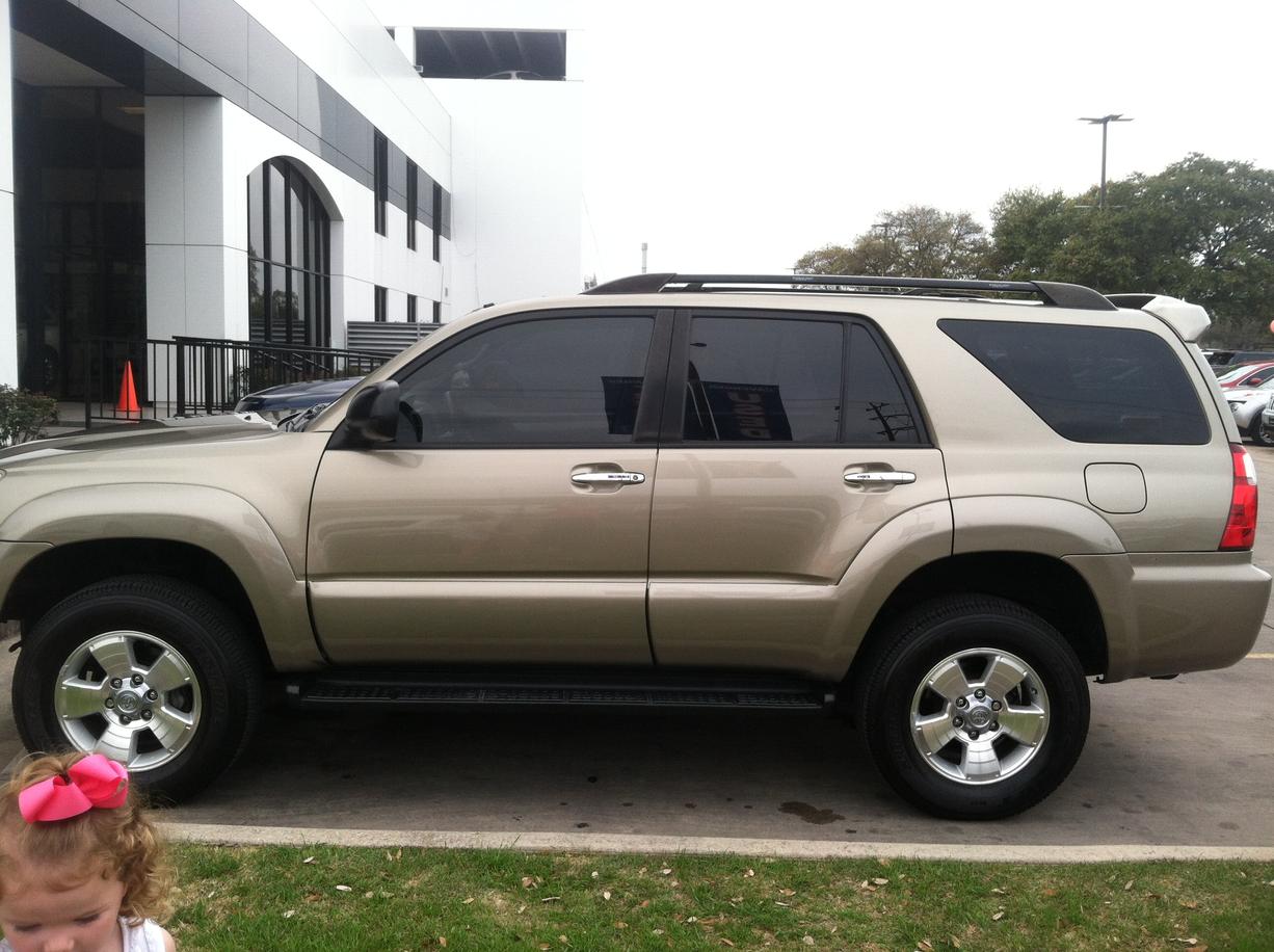

Was forced to pass on the '07. The owner was put into a tough spot, had an air transfer pump(?) that needed replacing and was told it was a $2k job (dealership and 2nd opinion). They didn't want to sell it as is (good on them), so the deal just bogged down.
But, not to fear. We did buy this beauty:
'06 SR5 V8 74,000 mi
