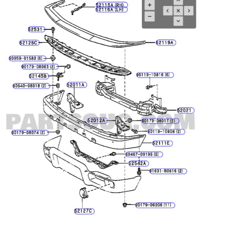

That cat knows but he /she won't tell you. To the point, the attached is a diagram for 2000 with a fat lip bumper but you can put your Vin into the toyotapartsouq.Com and it will show you the diagram for your fender and you can cross reference them with what you have.

Thanks Spartacus. I always forget about the great diagrams on that site. I found a vin for a random ‘98 and put it in, and got this:
It’s got a reference to a different page for the parts I need, but no way to get there. Any ideas?
