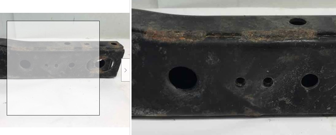

It would appear that this is the bare transmission crossmember - under $100....
TRANSMISSION Crossmember TOYOTA 4RUNNER 06 | eBay
clean threads in your area of interest....
I may be off on compatibility, but wanted to chime in in case it set off any lightbulbs
Cheers
Cheers
Thanks yeah thats the part. I have it going into a machine shop on Monday to drill through the parts. We will see how it goes. I have never seen such poor quality fasteners ever. I had a 30 year old VW rusted to shit with bolts that werent as bad as the 4 runner.
