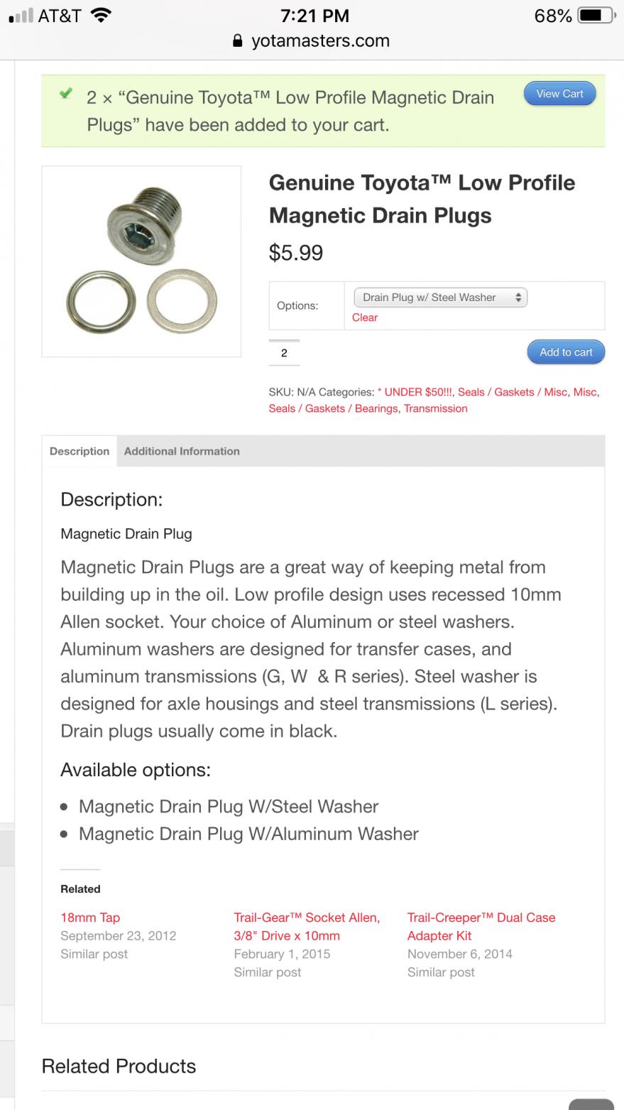

Anybody know if these will fit our transmission?
I serviced my trans today and accidentally left my magnets on the bench lol. I am not pulling it back off and cleaning those gasket surfaces again over some magnets.
Thanks.

Was really just hoping someone knew off the top their head of the trans and engine oil pan plugs were same size and thread?
The trans drain plug is 10mm 1.5 pitch. I’m sure the engine drain plug is bigger.

Thanks you! That’s exactly what I needed. I had ordered the magnefine filter as well since I can put that online in about 10 minutes.

I JUST had no clue what the transmission BOLT SIZE and thread pitch was, but if you read up it was provided so I am good to go.
