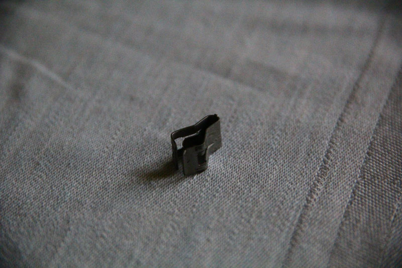

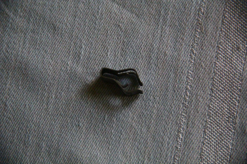

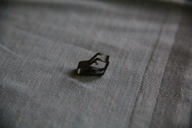

I undid all the wiring today, so I'll see if the battery keeps draining or not. However, I need two more of these one of them was bent (in the picture) and another got itself lost in the frame of the body. Part number or is that a general part I could get at a store?
