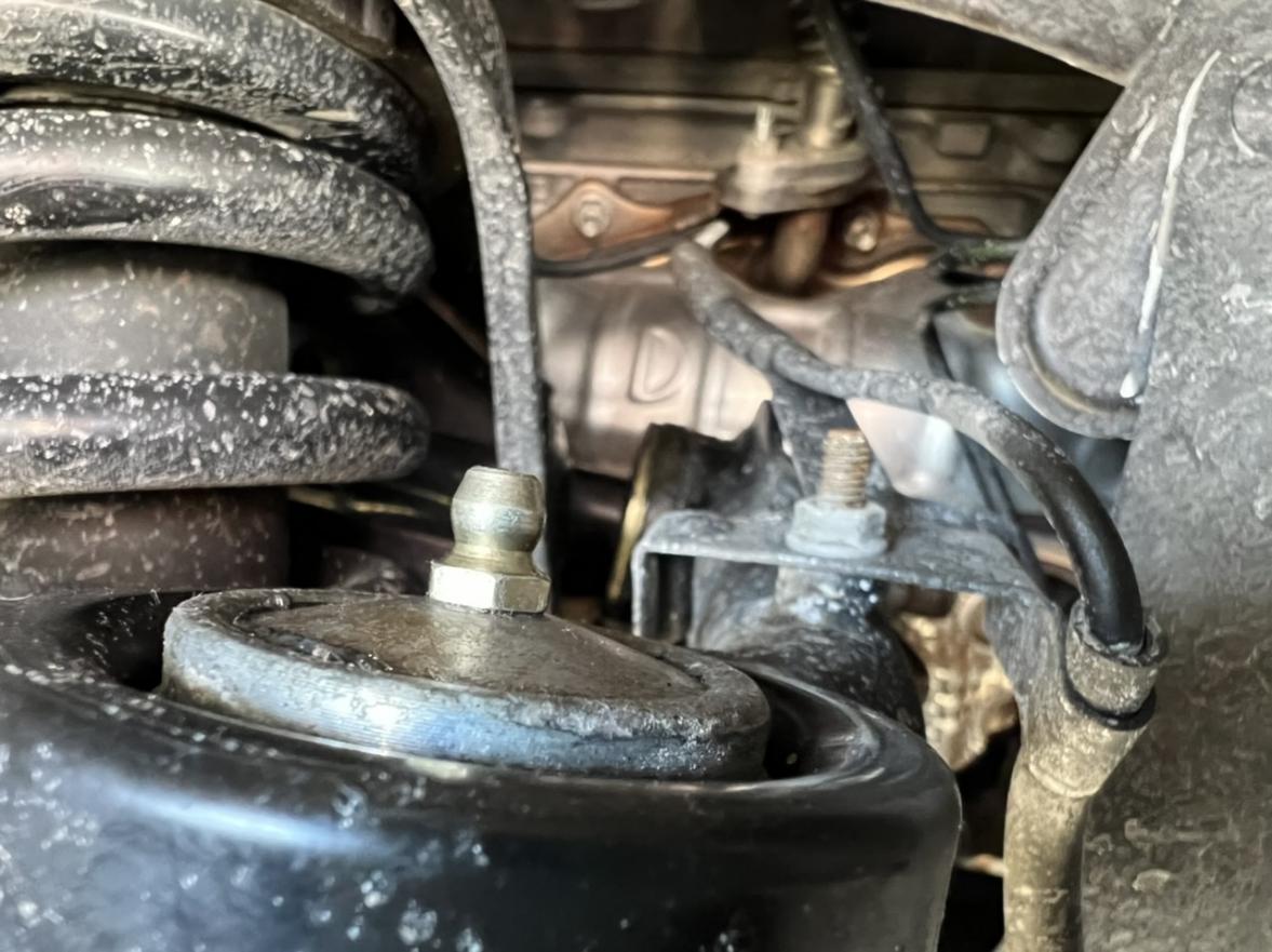

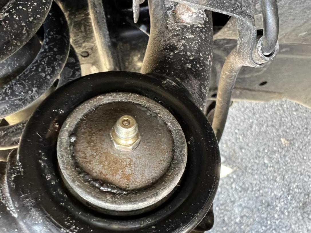

Well not so fast there. I’m at 1600~ miles on my joints and just noticed an issue. Where the zerk fitting is the metal is domed and has grease leaking out the sides. Just ordered the bilstein uppers. I think I’m done. Will get these warrantied and sell them after I fix it. Ughh! The bilstein sounds like a great alternative as it’s just a moog ball joint but will give me the caster I need.
