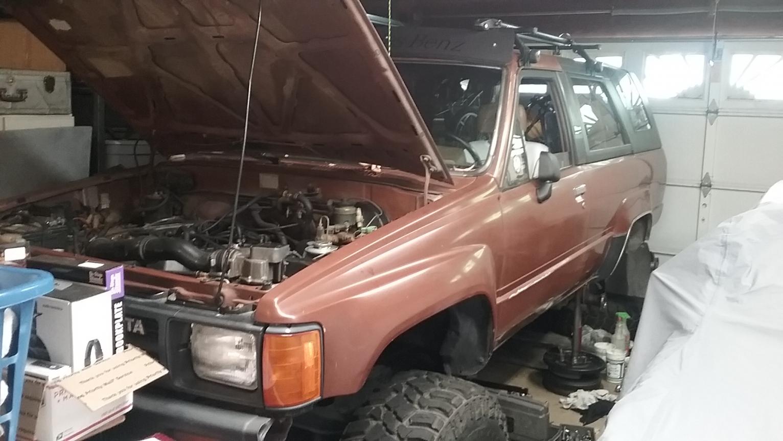

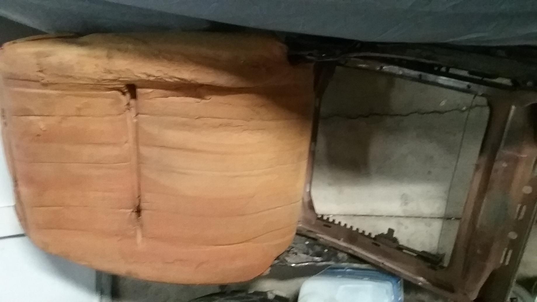

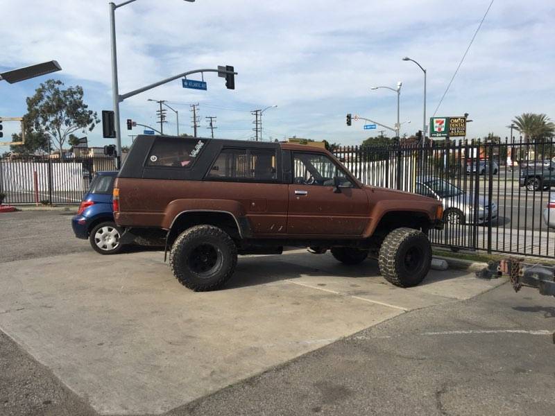

Thread on my 87' T4R. I found this on CL in Los Angeles after looking for a few months. Wanted something that was not too nice but not too much of a wreck either. I checked out a bunch but they all had issues I didn't care to deal with, cracked & bent frames, Rust, bad trans etc. This one is ruff, especially the interior, and leaked everywhere, but nothing I can't handle. Oh yea, it's a salvaged title, unknown reason with 303,xxx miles.

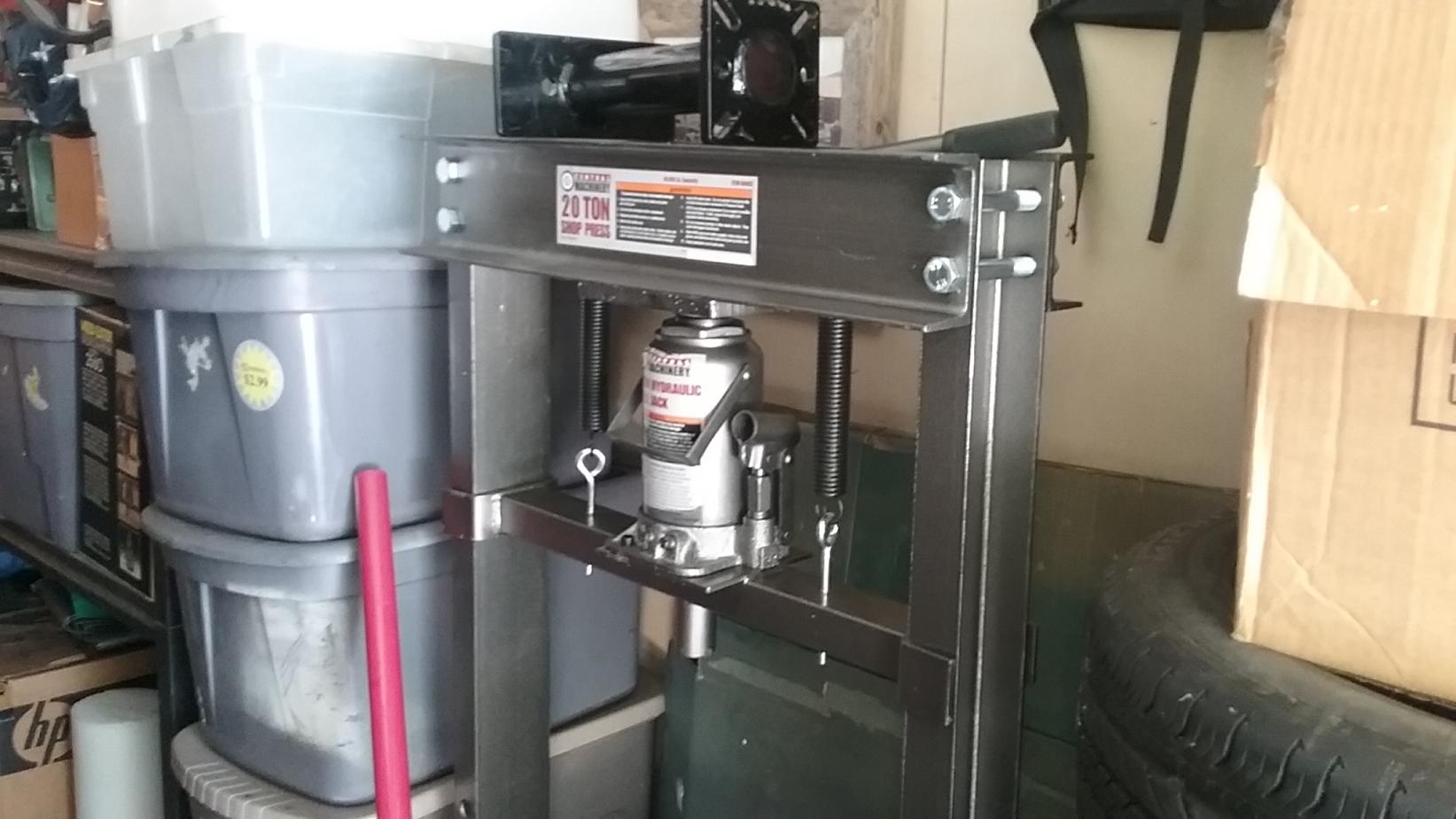

A few things I've done to bring it back So far:

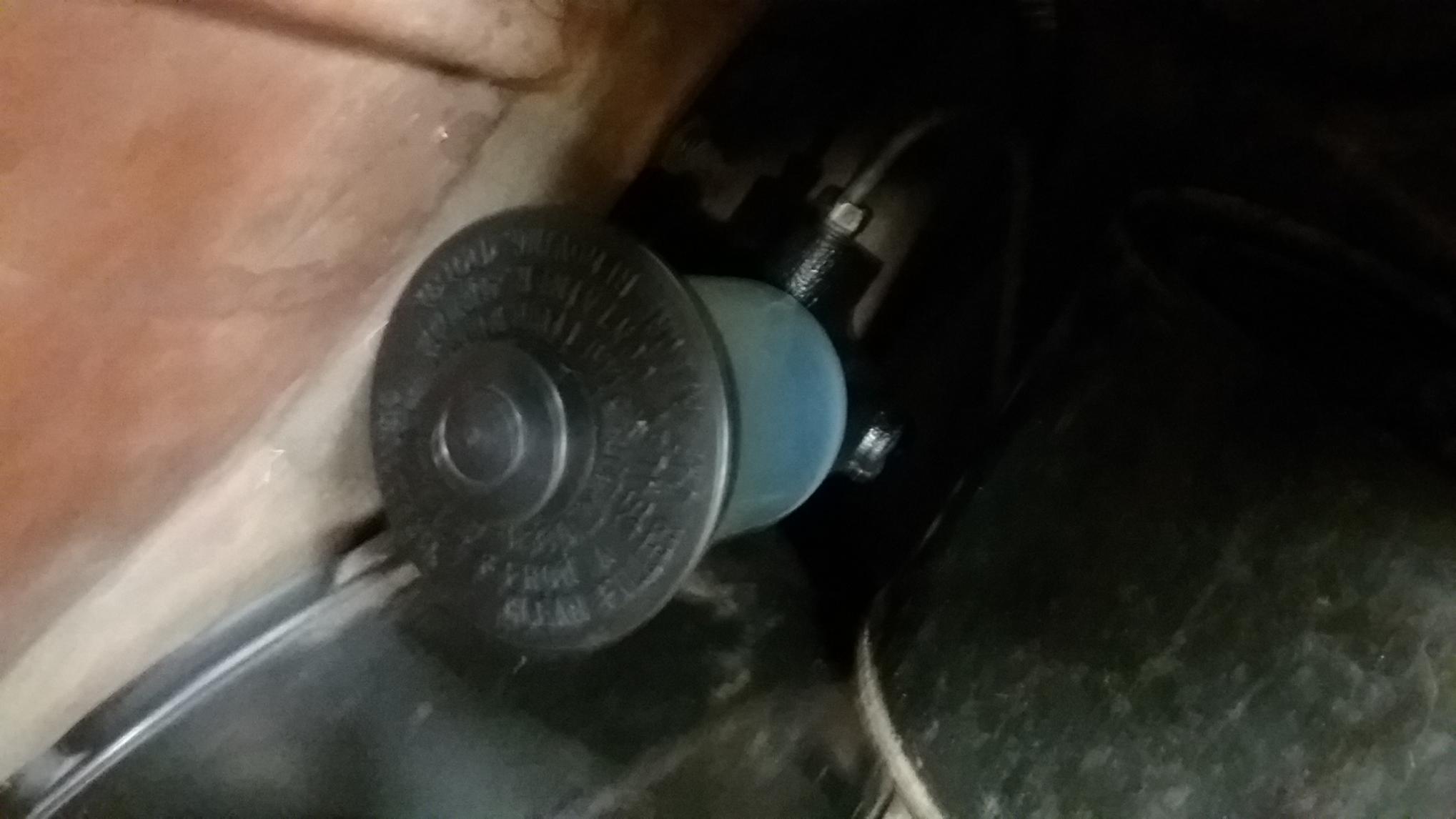

New Aisin clutch master
Resealed transfer out-put shaft

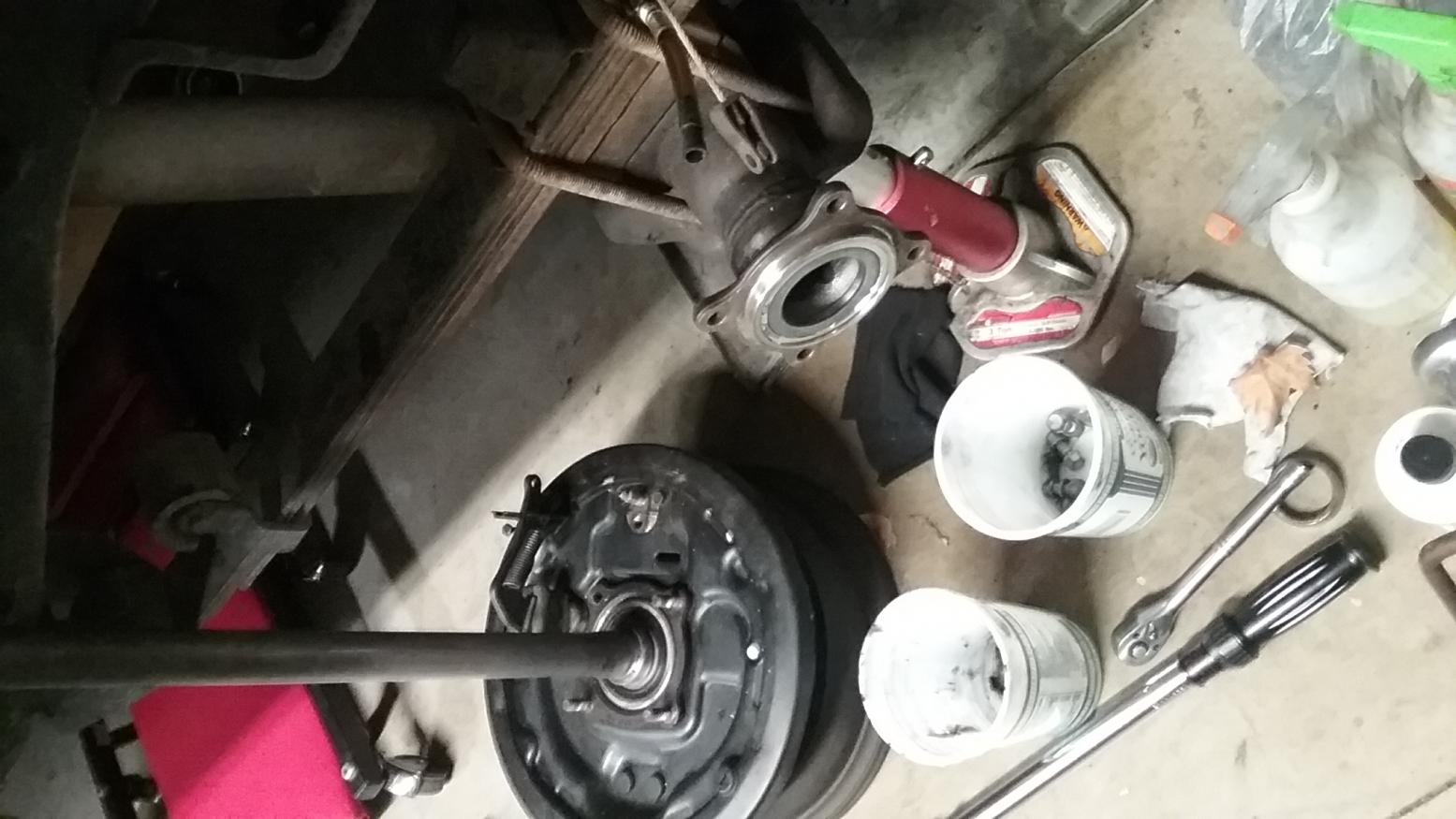

New bearings and seals for the rear axles

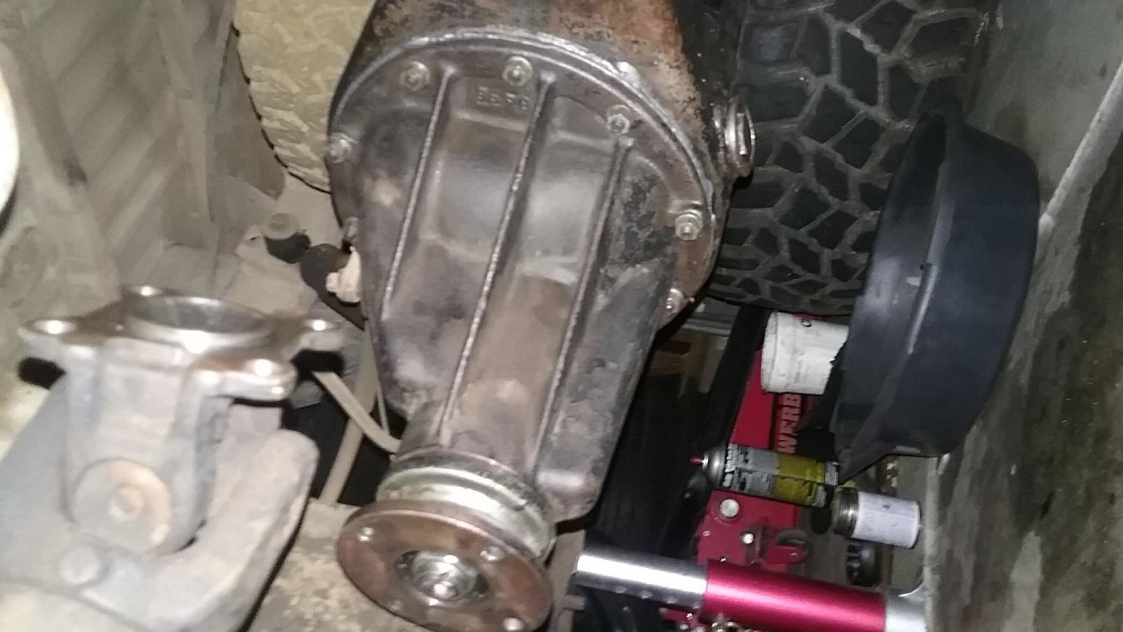

Pulled the rear diff & re-sealed it.

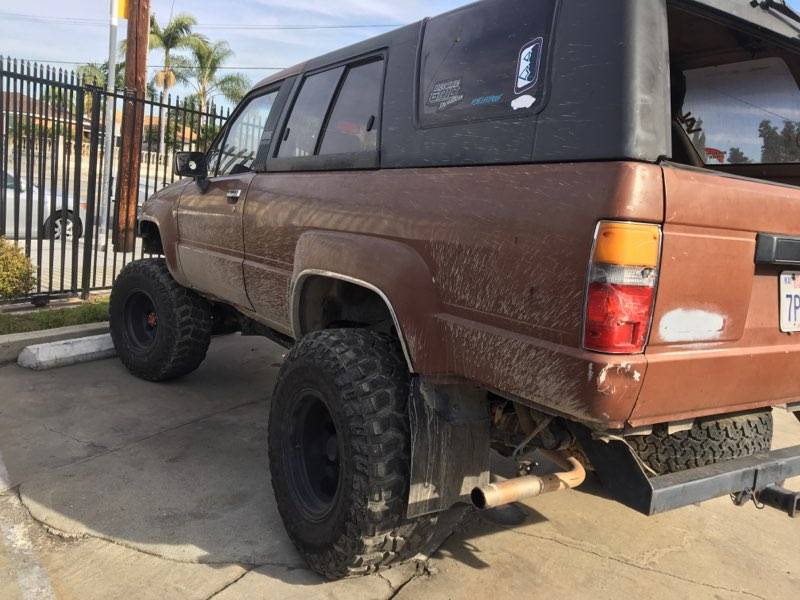

These are pics from CL add:
