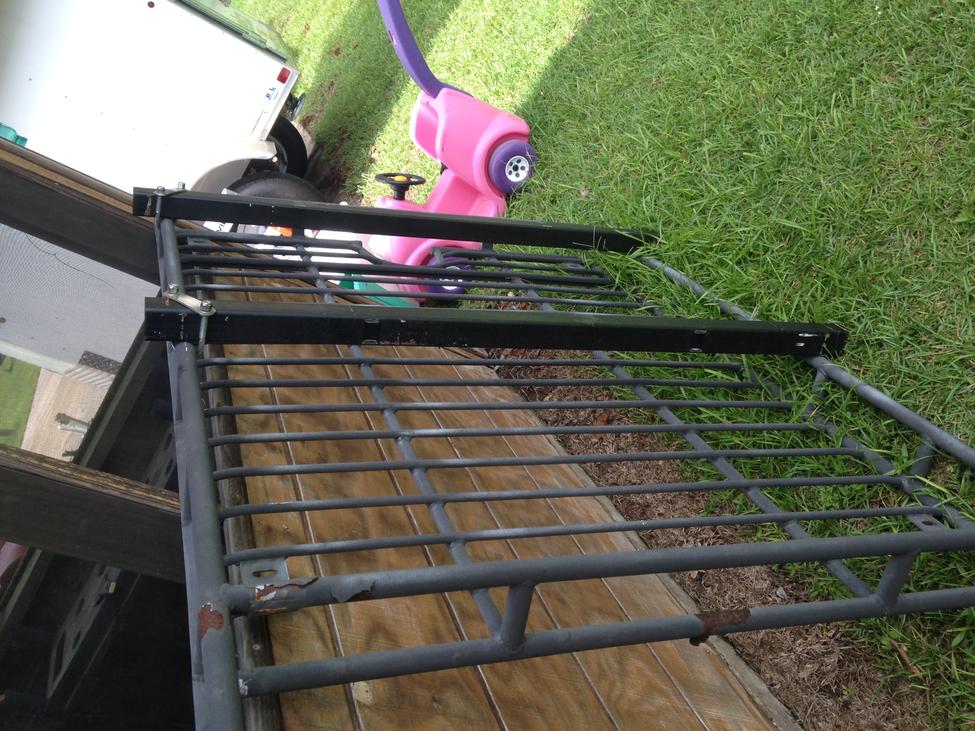

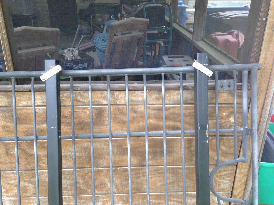

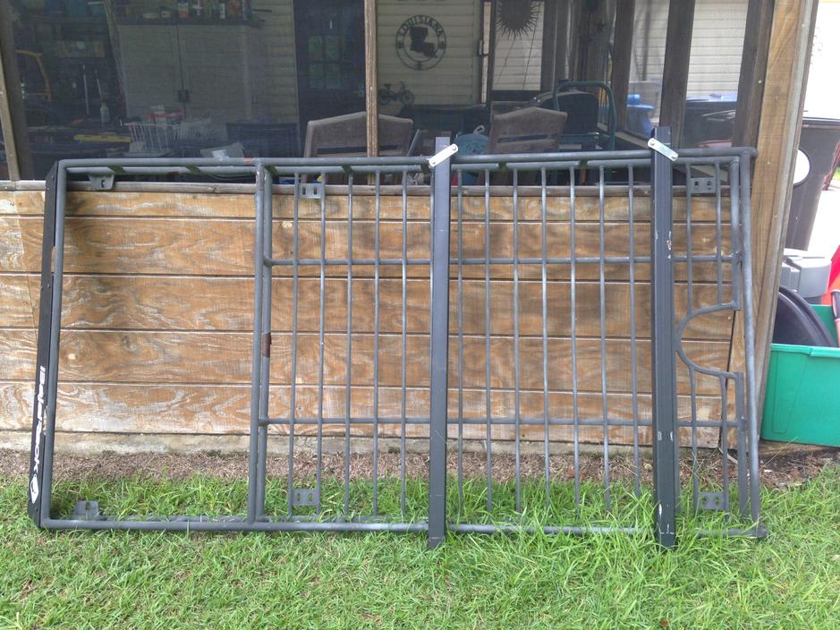

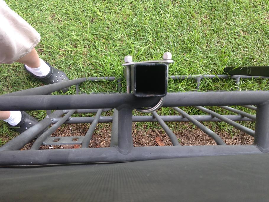

I got tired of waiting for my adapters from Baja Rack, so I made this. 2" square tube attached to the tent, then anchored to the side rails of the rack with 3" U-bolts. It ran like this for several thousand miles without problems before I changed to a different rack. None of the weight of the tent will rest on the mesh floor. You can even make four 2' long 1 1/2" wooden hangar dowels to use like stretcher handles for lifting the RTT on and off the rack. They can be stored in the 2" tubing by the addition of rubber caps. One 10' length of 2" square tubing is around $20 and I had them cut it into 49" lengths. In hindsight 50" would have been better to accommodate the rubber caps.
