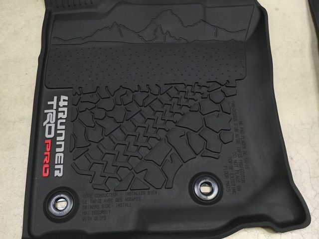

Anyone have these? Thinking about getting them for my Pro. I currently have Husky’s and I like them. No issues. I had Husky’s in my 2001 4Runner for 17 years and sold it with them still in there in decent shape.

We have Husky mats in another car and they’re great. That car floor is set deeper vs the door sill than the 4Runner.
Tried the Husky mats in the 4Runner and the passenger side edge curled upward so switched to OEM rubber mats and have been very happy with these.
I have those in our 2020 TRD Pro, Husky's in our Hummer H3, and Weathertech in our Grand Cherokee. The Toyota rubber mats are the most aesthetically pleasing and feel the heaviest but the don't have as big of a lip as the other two. If you plan to off road a lot and/or get in the car with mudding shoes or live in the rust belt, Husky's or Weathertech may be a better option. My only complaint about Weathertech is that their rubber sticker logos will fall off after a while, but they will send you new ones for free. Their customer service is also really good. I have their garage flooring and had an issue with it, and they sent the guys who designed it to my house to evaluate it and then gave me better flooring for free and let me keep the old flooring, which lives in my basement now. I also live about 20 minutes from their factory, so I probably got better treatment since they are right here, but a great company. I also have their dog bowls.
