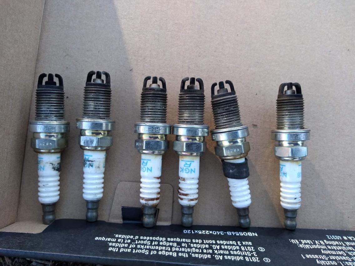

Changed the plugs, see attached pic, and cleaned the MAF sensor and still idling rough. Didn't drive it around and didn't get a CEL, so I assume the misfires are still in the same places. I'm going to have it towed to my buddy's shop and let him try to diagnose it on Monday. Worth noting though the rubber wrapped around the plug that came out of the #4 cylinder. Could this point to a bad plug wire?

The spark plugs have a lot of carbon build up which is in line with all your symptoms rich fuel mixture écu compensating for a lean condition. Taking to the shop is a good idea. please post when it's fixed to help others. Good luck.
