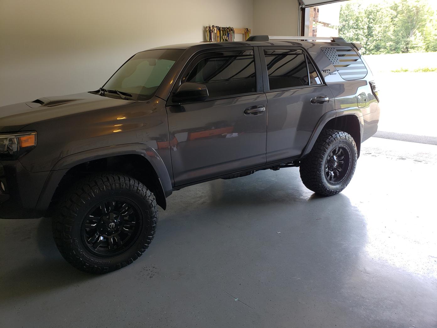

I got a gen 5.. trd off road.. did a 3" lift, bigger tire different wheel, decal in the back windows, blacked out the emblems and front where it was silver.
What do you think?

Looks good, might have been nice if you'd started your own thread, or maybe even posted in the correct forum though, lol...
What do you think?
I think you're posting in the wrong forum section, this is the 4th Gen section!!
You're also hi-jacking Matthew's build topic!!!
