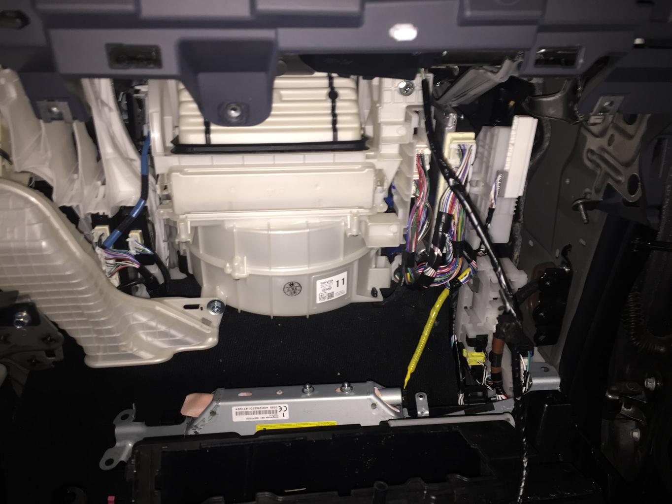

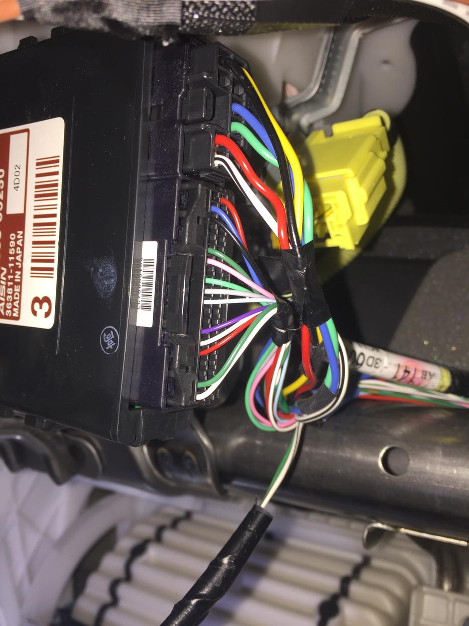

I would assume so but maybe someone else can confirm. I had my dash all apart a few weeks ago and spent an hour taking photos/confirming the wiring on my 2014.
Does anyone know why the 4runner seems to have a different 4x4 control system then the FJ. From what I understand the FJ has a 4x4 ECU and a Rear Dif Lock ECU where the 4runner it seems they have combined those units into the 4x4 ECU.

Thanks for the up close pics Engineer.
