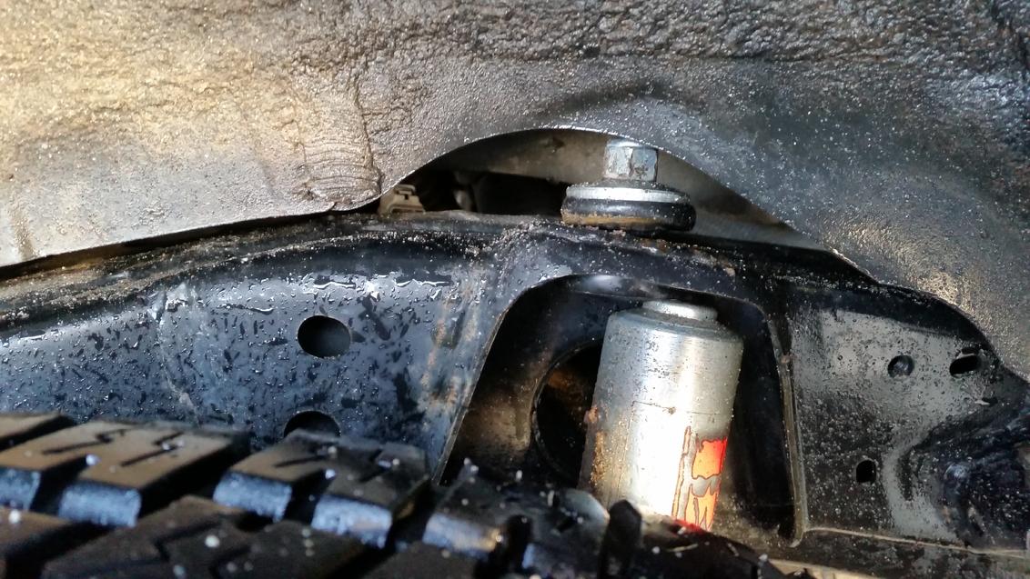

Heading off to work on a Monday morning is usually punishment enough. But this morning had a little extra in store for me. I noticed a fairly loud cluncking sound and an occasional metallic clanging sound coming from my rear passenger area. I got to work, got out of the truck and investigated the passenger rear tire and surrounding area and found that my 6 month old BOSS rear shock had a busted shaft. I'm pissed. I just emailed Toytec , hopefully they will take care of it as I have heard they have great customer service. Meanwhile can I drive this 6 miles home (all city driving) or do I need to get it towed?

No bueno. It certainly won't cripple your vehicle. You will do more damage to the shock and it may ding up the mounting area a bit. At least put some good scratches in it. No need to tow, IMO. If you can, unbolt the shock from the bottom and drive home carefully.

No worries on driving home I had issues with my long travel suspension before i had the shock mounts moved I had to drive home from the trail with one shock removed and the other one broken other than the clunking it was ok just be careful

I had mine installed last November. 2,000 miles ago. I talked to Miles [MENTION=57447]Toy[/MENTION]tec, great guy. He is sending a new shock and two sets of new bushings to me overnight. Interestingly enough, it is the bushings that cause the failure. They are way too hard, according to Miles, Eibach who makes the shocks worked with Toytec to fix the issue and made better bushings. If you have BOSS rear shocks, call Toytec and get new bushings before it's too late. I tried to get them to replace both shocks but Miles said he can only send me one. He did say if I see any evidence of rubbing or wear on the upper shift of the other shock that they would replace that too. All in all I found Toytec to be very cooperative. As far as the BOSS lift, until today I loved it, I'm sure I'll get over this little hiccup. It performs as advertised on and off road, to bad they didn't catch the bushing issue earlier in the game.

I just removed the busted shock then took it for a spin. Honestly it drives just fine with3 shocks...... going 35-45 mph... in a straight line. But I will say this, the ride home before I took the shock off was LOUD.

Apparently it's is the bushings. Call Toytec.
