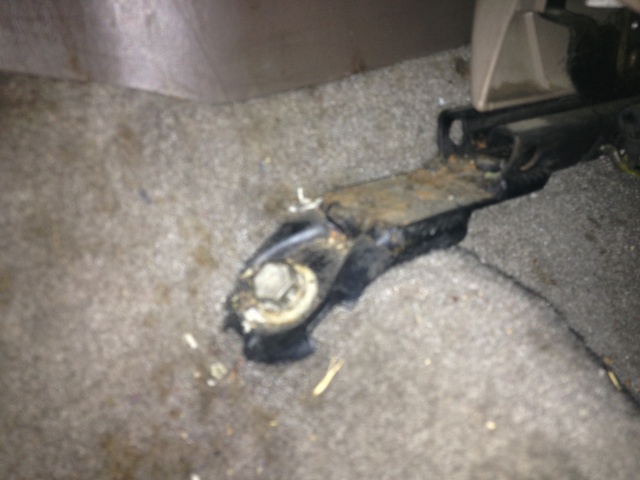

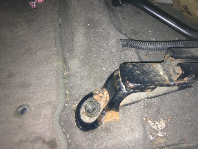

Back when I started driving my dad had the 4 runner taken to an auto body shop to get the guide rails extended about 3-4 inches by welding on two tabs to the front of the rail. The shop was a bit iffy about doing such a risky mod. I have horrible knees and I needed to have the seat extended so I could drive( I've had 2 total reconstructive surgeries with regrown cartilage) . My knees need to be at least 140 degrees or almost straight out to drive comfortably. The seat was extended leg room wise to accommodate up to a person 6'9'', yet I'm 6'1". The tabs are completely safe and have been working for at least 7 years now without any flaws. I could post a pic of them when I get a chance.

Sorry ToyOtis, I have been driving my Fiance's jeep all week and haven't had a chance to snap a pic, plus my primary Computer died this week that had most of my pictures on it. Ill try to get it up late tonight after work.
This is the only picture I have that kinda shows the extension, its what I got for now until I can get a close up.
there's a tab welded to the end of the track and then to the original leg and then a diagonal strut to help with stability.

As promised, here are some pictures. The rear used existing bolt holes or new ones were drilled.

Thanks for all of the pics, The Deec!
That little diagonal strut was a really smart addition too.
Did you modify the rear mounting tabs as well then?
