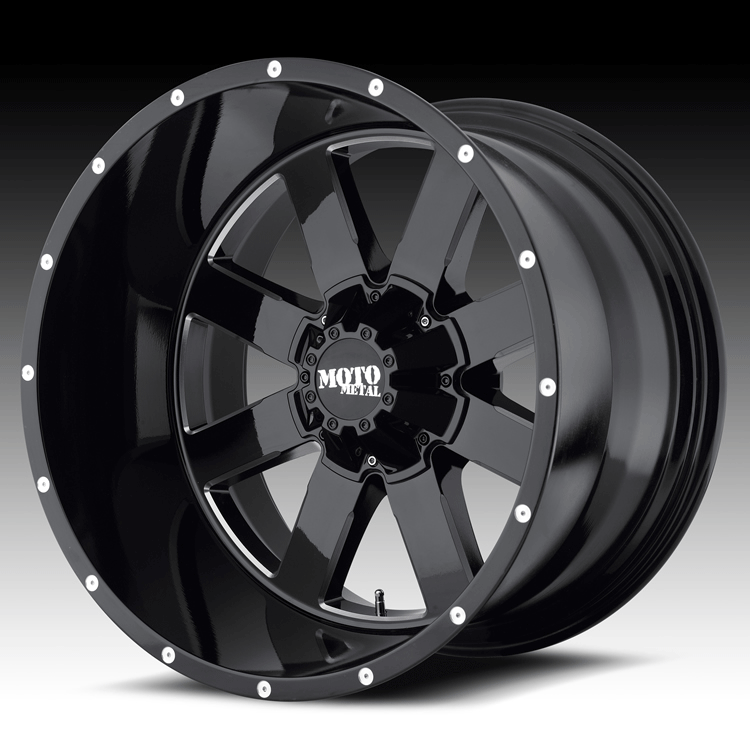

I've been looking for a simple and clean design wheels for a while now. Just came across these and they dont look too bad IMO. Anyone on the forum have these on their rig? The wheel comes in our spec. 20x9, 6-5.5 bolt pattern, 0 offset and 5" backspacing.
The wheel pictured have a very deep lip which dont fit our rigs. (20x12 or 20x14 -44 offset 4.xx bksp):(
Those don't look too bad. What is the offset on them? They look like they are sitting wayyy back behind the midpoint of the rim.

Here's what I found on wheel specs 18x10, 6 on 5.5, -24 offset, and $212.07 per wheel from 4wheelonline.com
orrr you can get even crazier with a 20x12, 6 on 5.5, -44 offset, and $267.91 a wheel from the same place.
Also 20x9, 6x5.5, 0 offset.
20x12 would provide that deep dish, but would rub on the slightest turn:lookout:

So, I just came across this forum. I really like these wheels Motometal 962. Will the 20x9 6x139.7 wheels fit without rubbing? 0 offset with 5 backspacing. Thanks any help would be appreciated! I have a 2012 Toyota 4runner limited (stock)
