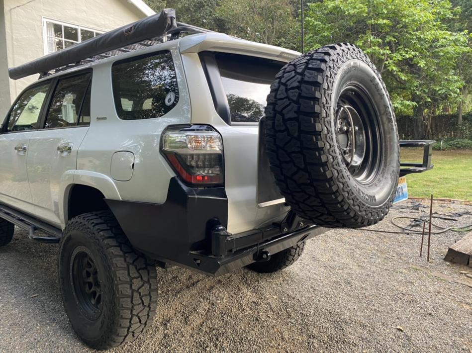

Just went through this myself.
For context, I’ve owned 3x sets of ST Maxx, I absolutely love them for a tough, off road tire that still performs in wet weather with good tread life (45k on my last set with around another 10k on them). *Edit: I've ran ST Maxx through trails in CA, NV, AZ, NM, and Baja, with no complaints.
I’ve also owned KO2’s, good tires but prefer the ST Maxx, better traction off-road and for the siping on the KO2 I felt like they should have been better in rain.
I just bumped up to 35’s and weight was a real consideration for new tires. I figured I’d just get another set of Coopers but they must have increased prices recently? They were running upwards of $320 a tire and since I needed five I figured I’d open up my search a bit. I looked hard at the Nitto Ridge Grappler and Toyo RT, but the weight increase really killed it for me, almost made more sense just to run a true MT at that point.
Long story short, after a lot of review I ended up with Mickey Thompson ATZ P3.. made by Cooper with a similar tread pattern. Treads are more aggressive on the Mickey’s, sidewall is more aggressive on the Cooper. I assume construction is nearly the same based off everything I’ve read. They were also less expensive and had a rebate going on, so it was an easy sell.
I’ve only had them a month so can’t comment on performance, but they definitely drive smooth for how aggressive they are. May be worth looking into at least. Hope that helps!

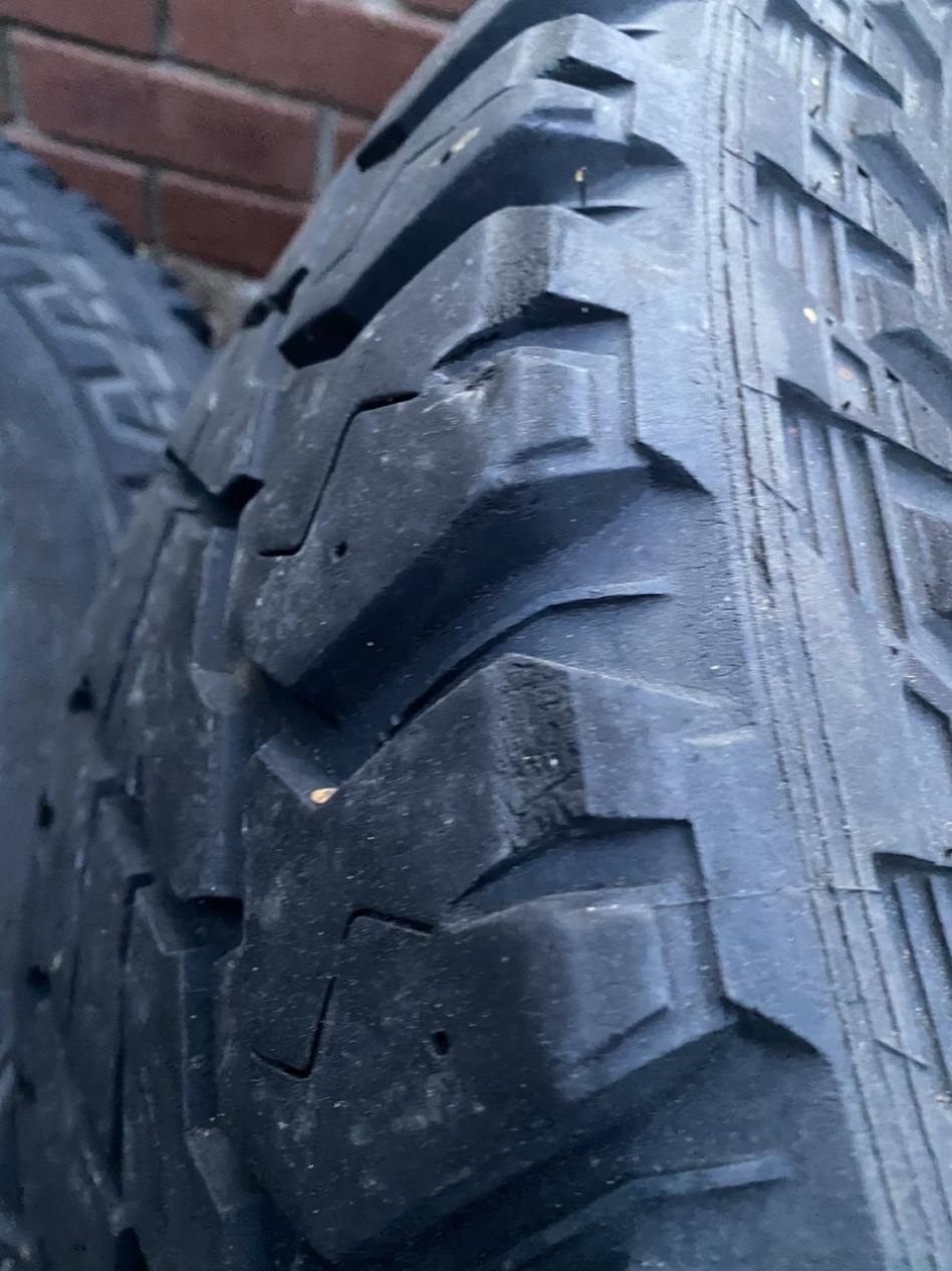

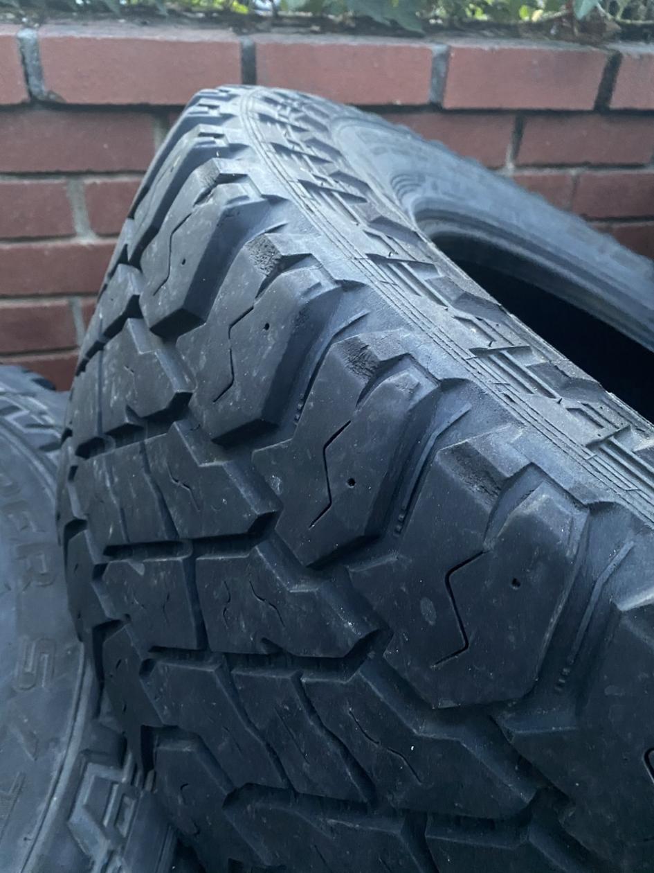

For reference, ST Maxx with 45,000 miles on them.
