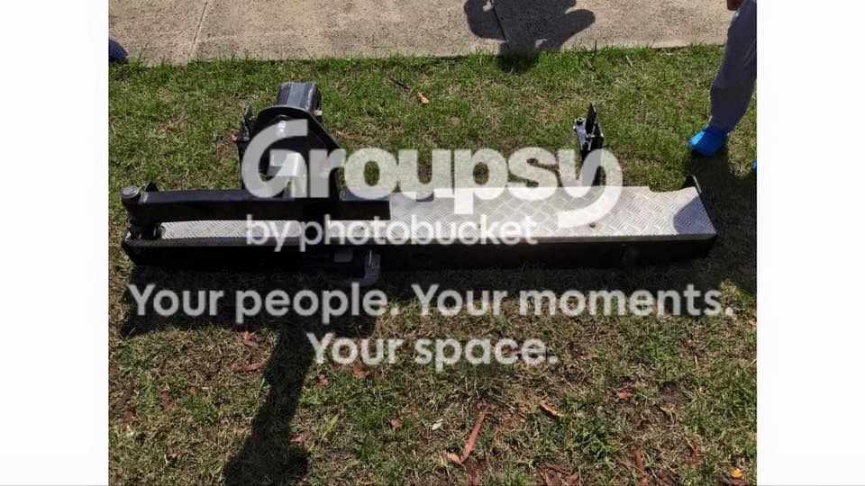

I have been looking for a LONG time but I finally found a Kaymar rear bar and tyre carrier.
It will sort out any issues with the panhard rubbing on the 33" spare in it's current position.
It will look the goods too!
Very disappointed.
I picked up the tyre carrier today from the freight company and it doesn't fit :(
The brackets are around 30mm too wide apart.
I'm going to pull the rear panels of the car next weekend and see if I can modify it to fit.
If not the seller has said they'll give me a full refund, but I'd rather get it on there.

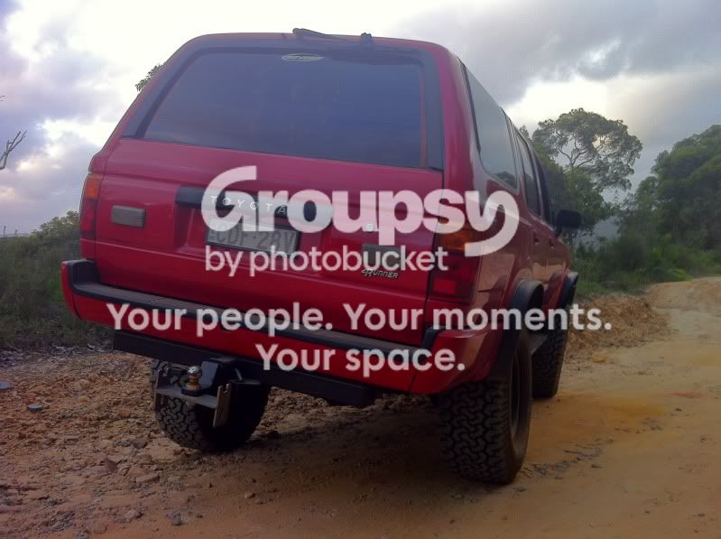

Had win with the rear bar today and managed to fit it :biggrin1:
I still have a couple of things to do tomorrow like move the number plate and wire up the light.
I also cut these down from the old towbar and will fit them on each side to strengthen it up.
I am also cutting up the rear 1/4 panels to clear the rear bar and will use some rubber edging to finish them off once done.
Pretty happy with how it's turned out so far :biggrin1:

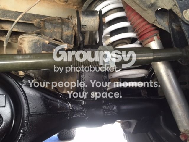

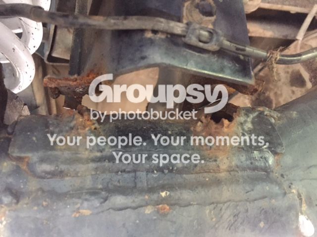

Will I broke the bracket off my diff AGAIN!
Its now getting the diff stripped completely and the brackets re welded and strengthened so it doesn't happen again :irked:

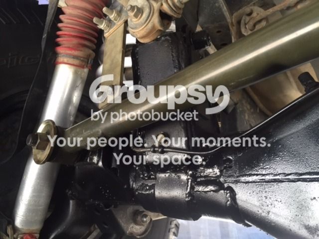

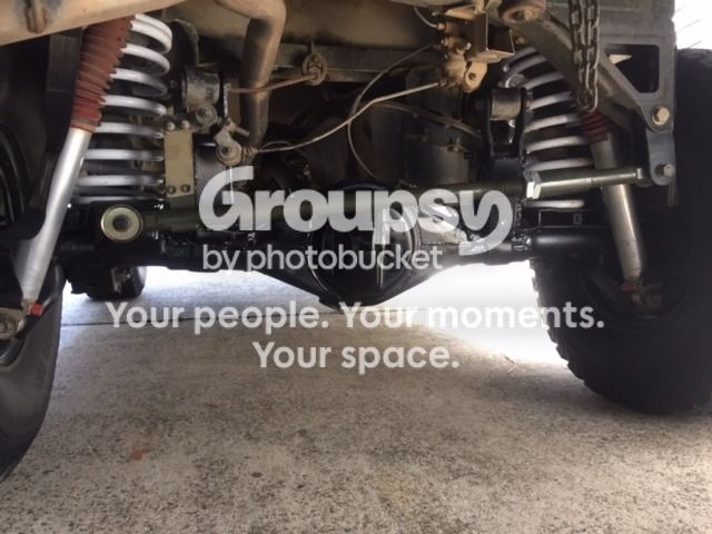

Picked the car up after getting the diff repaired.
Diff was stripped, acid dipped, brackets strengthened and re- welded.
Hopefully it doesn't break now!
