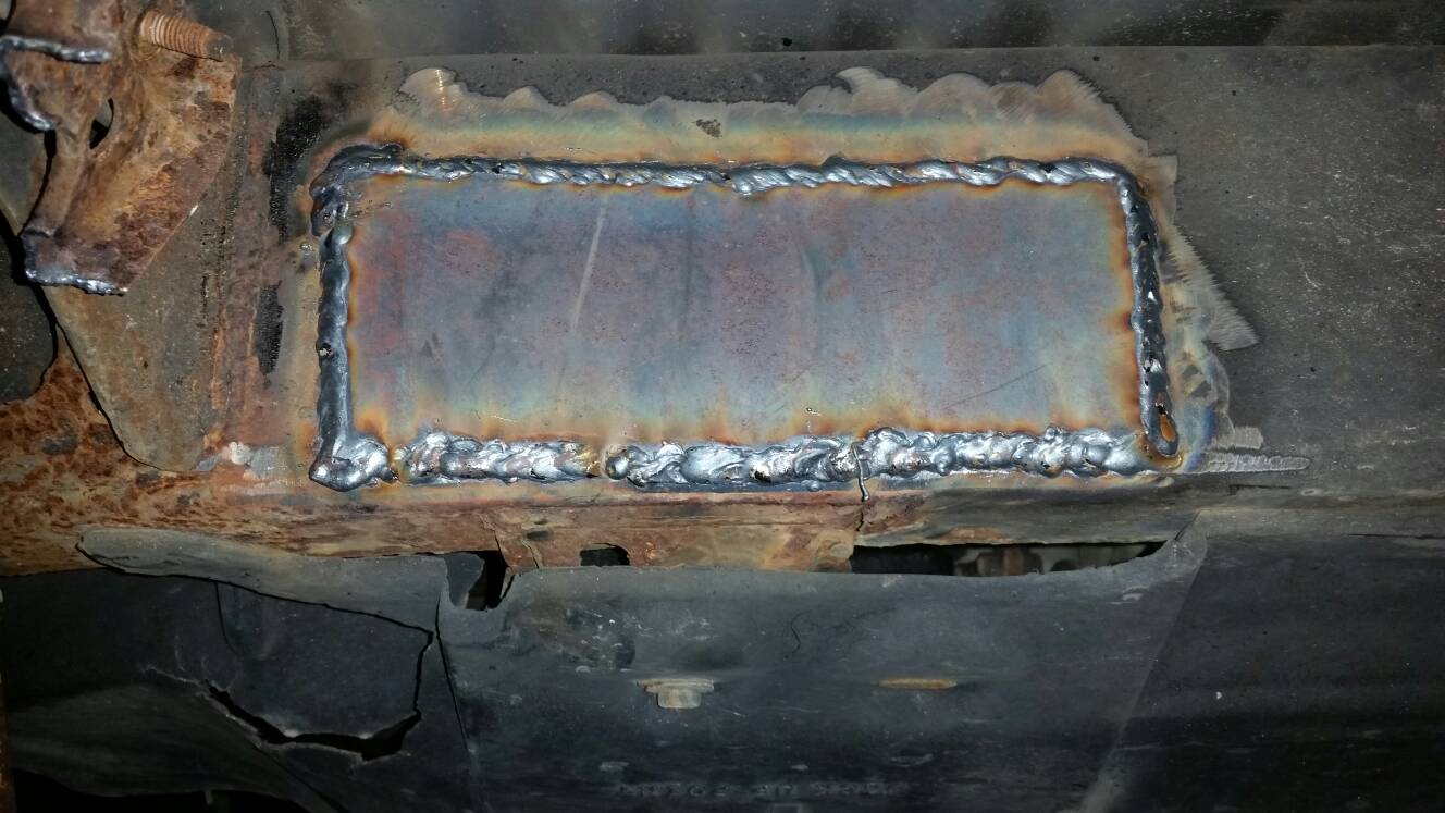

After getting a ticket for no inspection, I decided to have it done. I was surprised to be told the frame had rotted through above the passenger side control arm mount. I had looked the frame over and only saw surface rust every where else, even that was minor and not common. It's an otherwise clean frame. Sure enough after some searching, I learned that this area is very prone to rusting out.
IMG_20160916_210256114_zpsrvlfhwai.jpg~original
No big deal though, let's get started.
IMG_20160916_215443762_zpsrf6evnqx.jpg~original
Disclaimer, welds are done right now with harbor freight flux core. Given the material, I'm satisfied with the outcome. I found some Rustoleum cold galvanizing spray at Tractor supply. Hit it with that, then flat black, and undercoating. Should be good for a few years.
