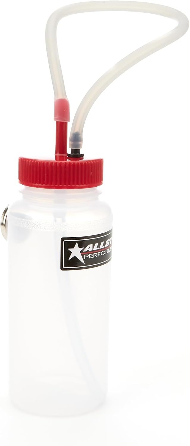

From my build thread -
I used this Allstar brake bleeder, worked like a charm -
PhoRunner's video & bleeder recommendation -
I also bled/flushed the clutch system- easy!

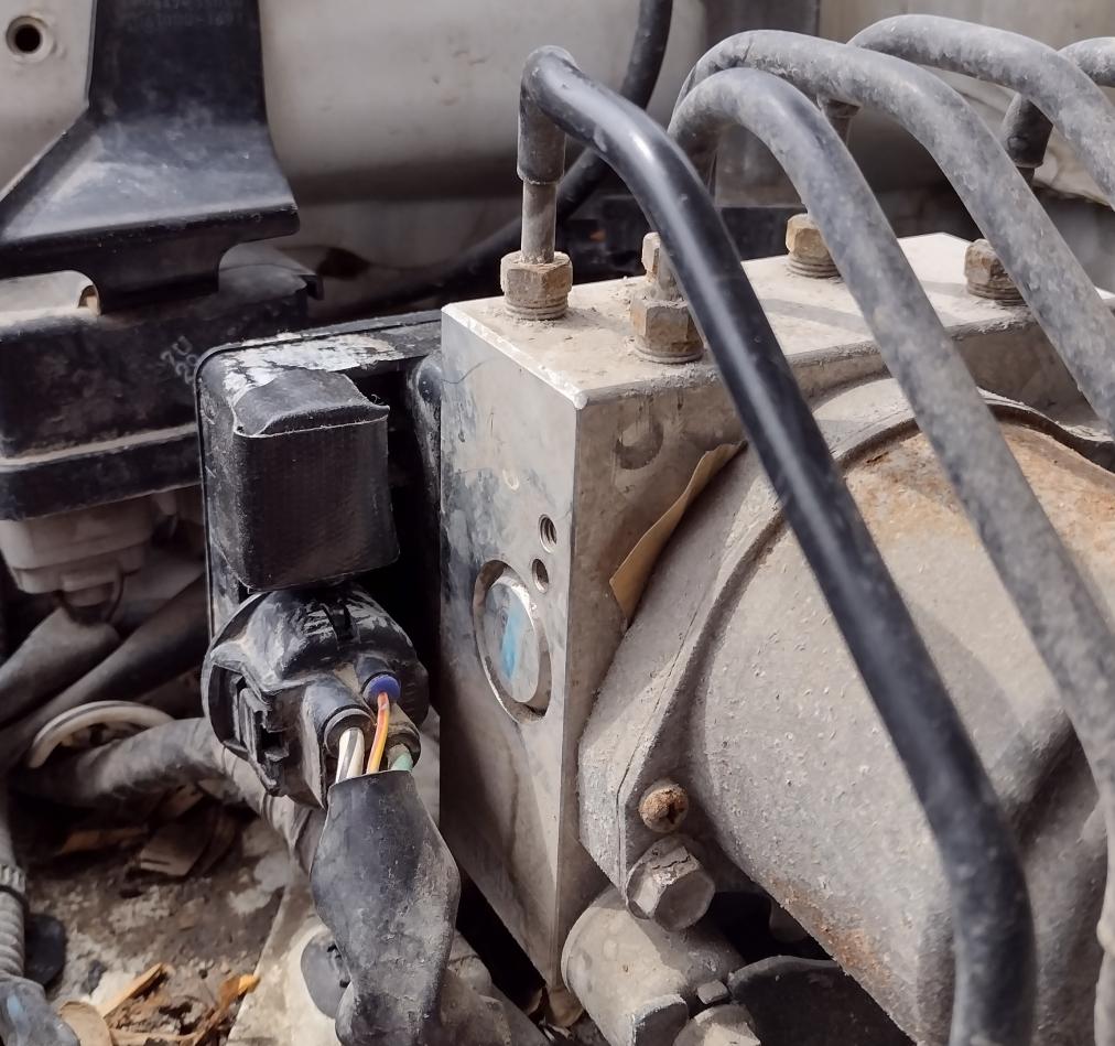

I bought my 2000 4runner in December of 2015.
The first day I drove it I slid through a 4 way stop because the ABS cycled on and off so slowly that it probably doubled my stopping distance.
I disconnected a connector on the ABS unit the next day and have been driving it since without any issues other than the ABS light is illuminated.
I spent 30 years driving without ABS in winter so not having it is not an issue for me.
My other vehicles have it and work well.
