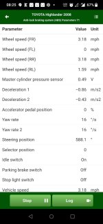

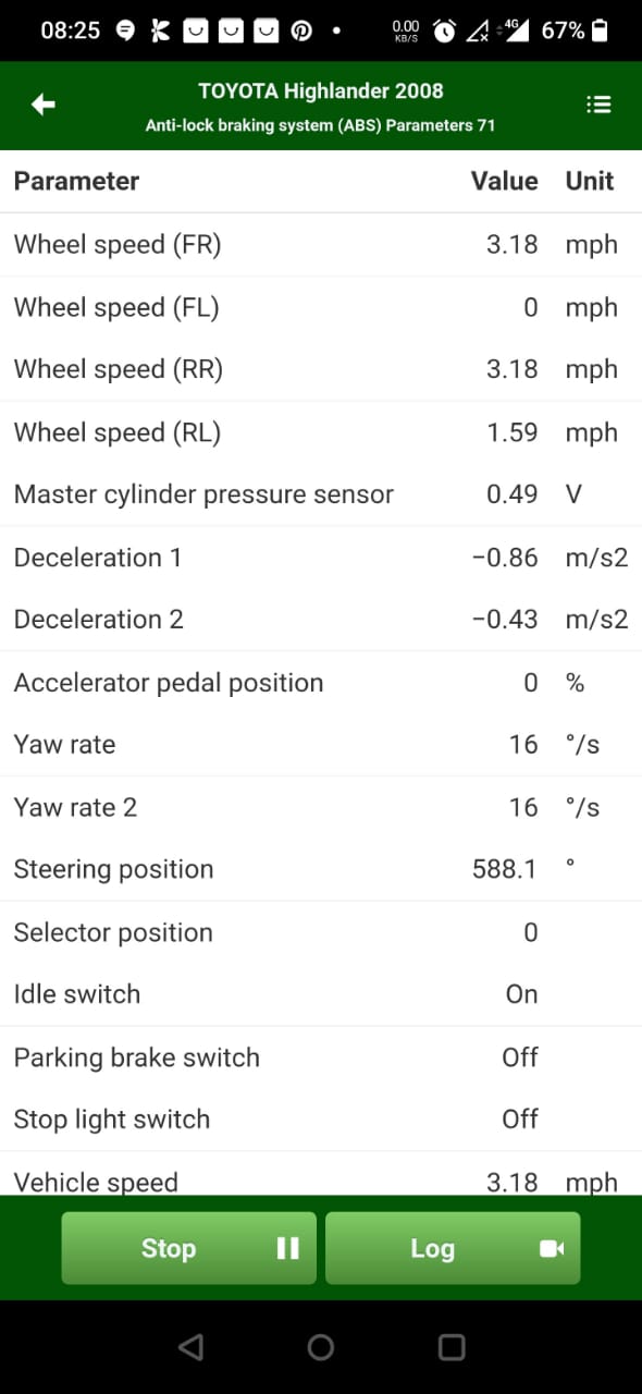

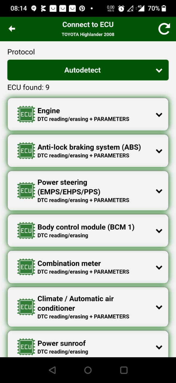

THE bluetooth reader elm 325 if mated to a compatible phone app like motodata obd, can read abs data , and even seatbelt data in compatible vehicles
Nope, that's a ELM327 so no ABS. I have one similar that I've had for years.
USE it with the app, i posted above, it works.
i can read abs codes with it, see it in action on a highlander
Well you did originally say ELM325. Interesting that you can do it. I wonder if it's a PID in the app and/or that particular code reader that allows it. The Amazon site even specifies "DOES NOT read or reset your SRS, ABS, Oil Change or General Maintenance lights (exceptions may apply with certain apps)".
